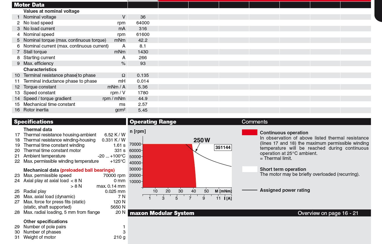

I have worked mainly with good quality servo motors where all these specs are measured and calculated pretty accurately. No "rule of thumb" numbers.
This is what a good motor spec looks like:
![4452.bldc.JPG 4452.bldc.JPG](https://www.electro-tech-online.com/data/attachments/55/55189-6c0338e96f101d947b915aeb63f152a0.jpg)
EDIT: Since dmta doesn't have all those "fancy specs", everything that gary350 said is very usefull "rule of thumb" info. We are just talking about two different cases here. I'm talking about small precision servo drives and gary350 is talking about industry workhorses.
