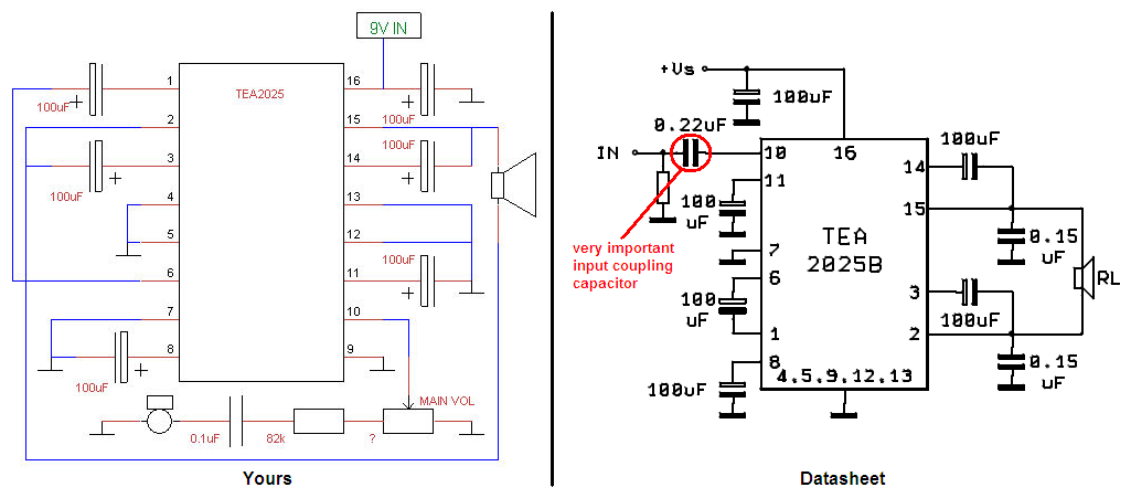

Here is a basic diagram of the amp section of the original megaphone circuit. The mic section just doesnt seem right to me, I would think the mic should be connected to Vs not grounded, and yet it worked?
I know these are simple questions but im always learning.
How do you know that you can just connect a microphone to the input of the TEA2025, or say the LA4270 (another suggested)? How do you just connect the mic, connect Vs to one side of electret, and other side to input?
Your mic is not powered so it is not an electret type. It has an 82k attenuating resistor which would reduce its level much too low.
The input current of the TEA2025 at the volume control will cause "scratching noises" when the volume control is turned. An input coupling capacitor is needed.

Alright so i have added the power circuit to the electret mic as per a diagram i found online, not quite sure what value to use for resistor for 12volt, 2.2k seemed to be the one most used.
I also have the input capacitor added. Is this ok?
The little TEA2025 will melt if its supply is as high as 12V when it is bridged. The datasheet shows 9V max.
You still have a coupling capacitor missing at the input of the amplifier. Look at the datasheet!
Your electret mic should be powered from 10k resistor and the 10k resistor should be powered from a filter made with a 1k resistor in series and a 47uF capacitor to ground.

Have i got it about right this time? You reckon the 10k pot for adjusting mp3 vol is enough? Thanks again for youre help with this
