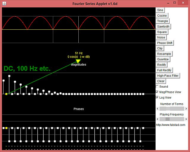

There is no fundamental after rectification.. WHen cap is added asymmetry adds even harmonics.
325Vdc from 230Vac.
That is why there must be a load.

All rectifiers on AC double the fundamental frequency
Yes but the 0.68uF cap does not know there is rectification happening. The 0.68 sees 50 or 60hz. The 220uF cap does see 100 or 120hz.

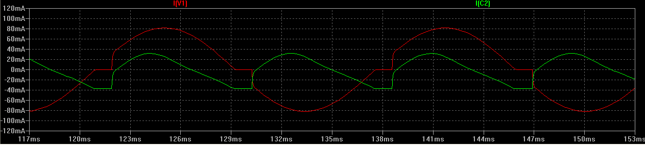

Red trace is 0.68uF current, 60hz. Green trace is 220uF current, 120hz.

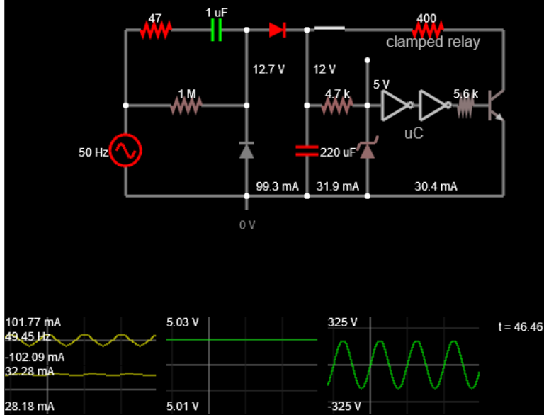

Ignoring Zener for now, I compute loop current of relay as follows.
Xc(f) for 0.68uF @ 50Hz ~ 4700 Ω, for C1, but when switched off 50% from diode it becomes 9400Ω .
The 30mA 12V relay coil is 400 Ω
The original schema 47Ωx2 = 94 Ω, R4,R5
Ztotal = 9900Ω ~10k, thus If= 230Vrms/10k= 23 mA which is margin for 30mA relay.
Changing C1 to 1uF , Xc(50Hz)@50%d.f.=6366Ω,
Ztotal=6860Ω, thus 230Vac/6860=33 mA
https://www.falstad.com/circuit/cir...+9.765625e-55+1+-1 o+0+64+0+290+640+0.1+2+-1
I agree on several things you show.
Change the base resistor from 1k to 4.7k to 10k. You show 5.6k. (I think a MOSFET is better)
Change the resistor that feeds the 5.1V Zener. Probably the 1k eats too much current. I agree with the 4.7k. (depends on what is happening with the micro)
You like the 1uF cap and two diodes.
I think the 0.68uF cap and 4 diodes has less board space and less cost. (I did not look up the price)

4k7 *220uF has a 1 second time constant = 100 * 10ms charge interval , (1/f) for half wave rectifier.

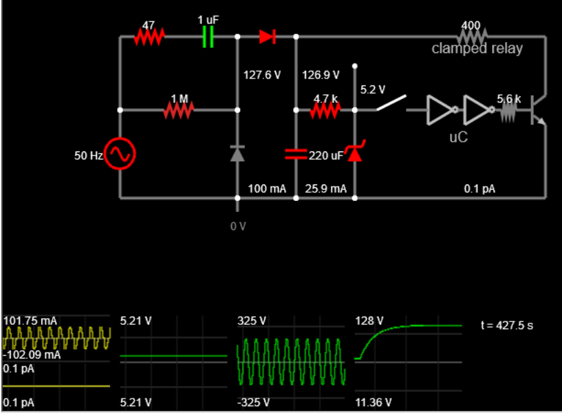

Using this Zener current limit causes problems for C2 voltage when Relay is OFF
So my selection in #24 is flawed with 4k7.
Using the 1uF equivalent impedance to 4k7+Zener is insufficient to load series Cap the load ratio like a resistor divider,
C1 to 1uF
, Xc(50Hz)@50%d.f.=6366Ω, so C2 voltage blows up.

The DC model of the supply is a 320V DC supply and a 6k resistor charging the 220uF cap. The cap will charge up too much. The current needs a place to go so the cap will not over charge.
If you look at post #1. He did not have enough current to run the relay AND too much current for just the micro.
Now with the 1uF cap OR the 4 diodes there is power for the relay, but TOO much current for the micro. A Zener is a good way to limit the voltage.

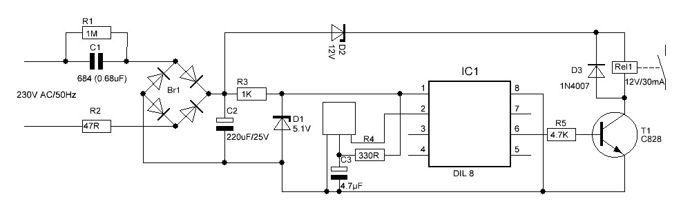

Hi thanks for the support.Got lots of design considerations.
I changed from half wave to full wave as ron mentioned.
Here is the one I am going to use.I need a compact design because i have a very limited space.
Please guide me.

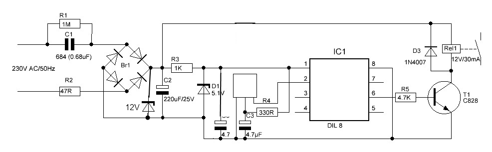

Moved Zener from relay to 12V supply.
Added cap to +5.1V supply. (micro needs cap on supply)
How much current does the micro consume?
How much current does the temp censor consume?
For "Br1" is this one part or 4 diodes?
D3 1N4007 could be 1N4001,2,3,4,5,6 or 7. Or any small diode like 1N4148, 1N914.
C2 220uF 25V could be 16V because if there is a 12V Zener across the cap. This cap will be smaller.

Which reminds me when I said, understand why you are wasting power in the Zener, one reason is to prevent overvoltage in the C1 charge pump into C2, when Relay is OFF.
Adding another Zener for 12V or a lower R5 like 470R when relay current (400 Ohms) is when off. If so choose, 50V 220uF cap normally rated for >=200mA ripple current and appropriate power passives.

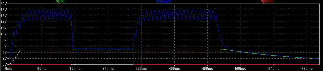

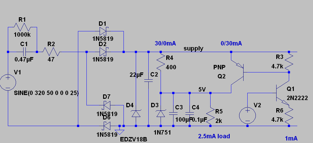

Here is a very strange idea: We were trying to make a supply for 30mA for the relay plus 3.5mA for the micro and IR thing.
Size of the PCB is critical so I want to change the two bigger parts.
I changed things so power to the relay also flows through the micro. So 30mA is all that is needed not 33.5mA.
I changed the 0.68uF cap to 0.47uF to make it smaller.
At first I removed the 220uF cap and things worked BUT a spike on the power line killed the supply!
Then I made the 220uF cap only 22uf and placed a 18V Zener across it. (important)
I made C2 small (25V) and C3 larger (6.3V). R4 is the relay and its current goes through D3 to power the micro.
When the relay is to be off Q2 shorts it out. (no diode is needed)
Q1 is a 1mA current source. probably 0.5mA would work fine.
V2 is the micro.
At low line 50hz D4-18V Zener has not current.
At high line 60hZ D4 eats up the excess current.
In this case, the micro should be run at full speed to help eat up more current. In fact you could add more parts because there is 30mA at 5V that could be used up. R5 is the micro current of about 2.5mA.
This is a very strange design. The goal is to reduce the size of the 220uF cap.
RED trace is the output pin of the micro. (off---on at 150mS---off at 300mS) power goes off at 500mS
BLUE trace is the supply. (12V+5V) Ripple is fine.
GREEN trace is the 5V supply.
