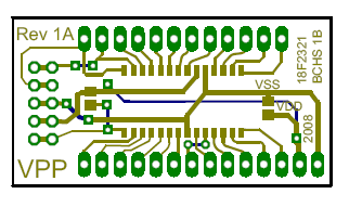

I generate excellent PDF graphics from Eagle and import them into open office text documents.
Generate images of schematics or boards from eagle by selecting PDF from the print dialog.
Open the PDF using adobe reader. Use Tools>Select&Zoom>Snapshot_Tool. The snapshot tool allows you to select all or any part of the pdf and save it to the clipboard.
Next use your favorite image tool (gimp here) and do a "paste as new image" sort of thing. At this point you should be able to save it in any format your tool supports.
Import it into you text editing tool.
brd_1a-png.22842
