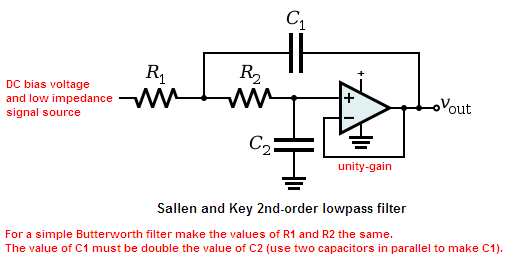

Your filter has a gain of 2 (not unity gain) and way too much feedback so it is an oscillator. Look at Sallen and Key filters in Google.
Your "gain of 10" opamp does not work because its input is missing a DC bias voltage. If it was biased then its output would be saturated against the positive supply rail because its feedback is missing a capacitor to ground. If it worked then its gain would be 11, not 10.
Here is a simple Butterworth lowpass filter:

Yes, use a low pass filter with an upper cut-off of 130Hz.

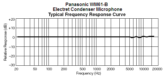

Can anyone tell me the name of a microphone which is sensitive enough to detect frequency's as low as 1 HZ........ Actually the mic I am using loses its sensitivity below a 100 HZ......
You cannot hear frequencies below 20Hz. The response curve of a high quality electret mic stops at about 22Hz because they do not have anything to accurately produce lower frequencies.
1Hz is almost DC. It is air moving slowly back and forth.
Why do you want to detect 1Hz?

The water jet will make air vibrate at a very low frequency only if it is very large. Look at the size of a woofer speaker then look at the size of a sub-woofer speaker. Look at the size of the vocal chords of whales.
You also need to go down to 0Hz (DC) which isn't possible with a microphone, may be a barometer could be used for the really low frequencies?
