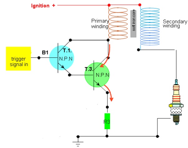

Hi. I am doing a project where i need to control the spark plug based on a condition. If a pin goes high, then the spark plug should function else it should be disable. I have attached the possible circuits which can be used to interface the spark plug with the Micro-controller.
In circuit 1 , they have configured the transistors as Darlington pair. Is it used to get high current gain?

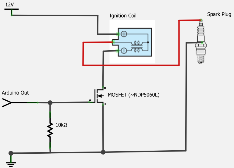

In circuit 2, only one transistor is used for switching action. Can that transistor alone drive the circuit ? :confused:

hi
A vehicle Ignition coil draws approx 3 to 4 amps from a 12V battery supply.
In circuit #1, depending upon the value of R3, a 5V MCU output pin may not be able to drive the Darlington pair into saturation.
You also MUST consider some form of back emf snubber for the transistors,
On circuit 2, the 5V from the MCU must drive the MOSFET into saturation, also back emf protection is required,
Regarding just switching the driver ON/OFF, remember that the EHT spark is produced when the driver is turned OFF,
You must also allow sufficient ON time for the driver [dwell time[ to ensure the coil current has reached its maximum value.

Thanks for your reply sir.:)
"You must also allow sufficient ON time for the driver to ensure the coil current has reached its maximum value"- How to determine this time sir.
Also can i use a signal generator with square pulses instead of all these circuits and control the spark plug by controlling the voltage from battery using relay?
You could use a SigGen to drive a relay, but add a back emf protection diode across the relay coil to protect the SG
Also add a suppressor across the relay contacts.
The minimum dwell time could be determined using an oscilloscope measuring the coil current.

That Code wouldn't work. You turn on PORTC.0 2 times, so it is always switched ON.
Be careful in your choice of protection of the driver circuit. A relay as said would be the simplest way to switch the primary with an anti arcing cap across the contacts. It's the huge back EMF on the primary when the circuit is opened that induces the even bigger spark voltage in the secondary as the magnetic field collapses.
As for working out how the current maximises timewise in the primary, I wouldn't worry too much as ignition coils can run over a fair range due to engine speed using simple points as switches in older cars.
