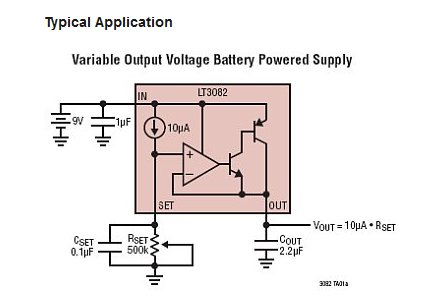

This is where simulations and real world circuit design drift apart. The V2 logic supply in LTSpice is a clamped hard voltage source. In reality it may consist/likely consist of an NPN pass transistor forward biased to supply (source) the current to a circuit. Think of it like a diving board at a swimming pool. You can pull like hell downwards and it will stay firm. However pushing it up lifts it off its stand easily.
Even with a 10K resistor in series with the 24VAC input, it could reverse bias the pass transistor in the regulator thus causing the voltage to lift where the regulator ceases to work. It cannot sink current due to this reverse biasing of the pass transistor. This can put a high voltage on the rest of the circuit run from the same regulator.
A clamping zener across the output of the regulator would help such lift. A 5.1V zener is stable enough to deal with this as it is the best of both worlds with Zener and Avalanche breakdown.
If you can use a Linear Tech regulator instead of a library voltage source as LT Spice will simulate the problem correctly.

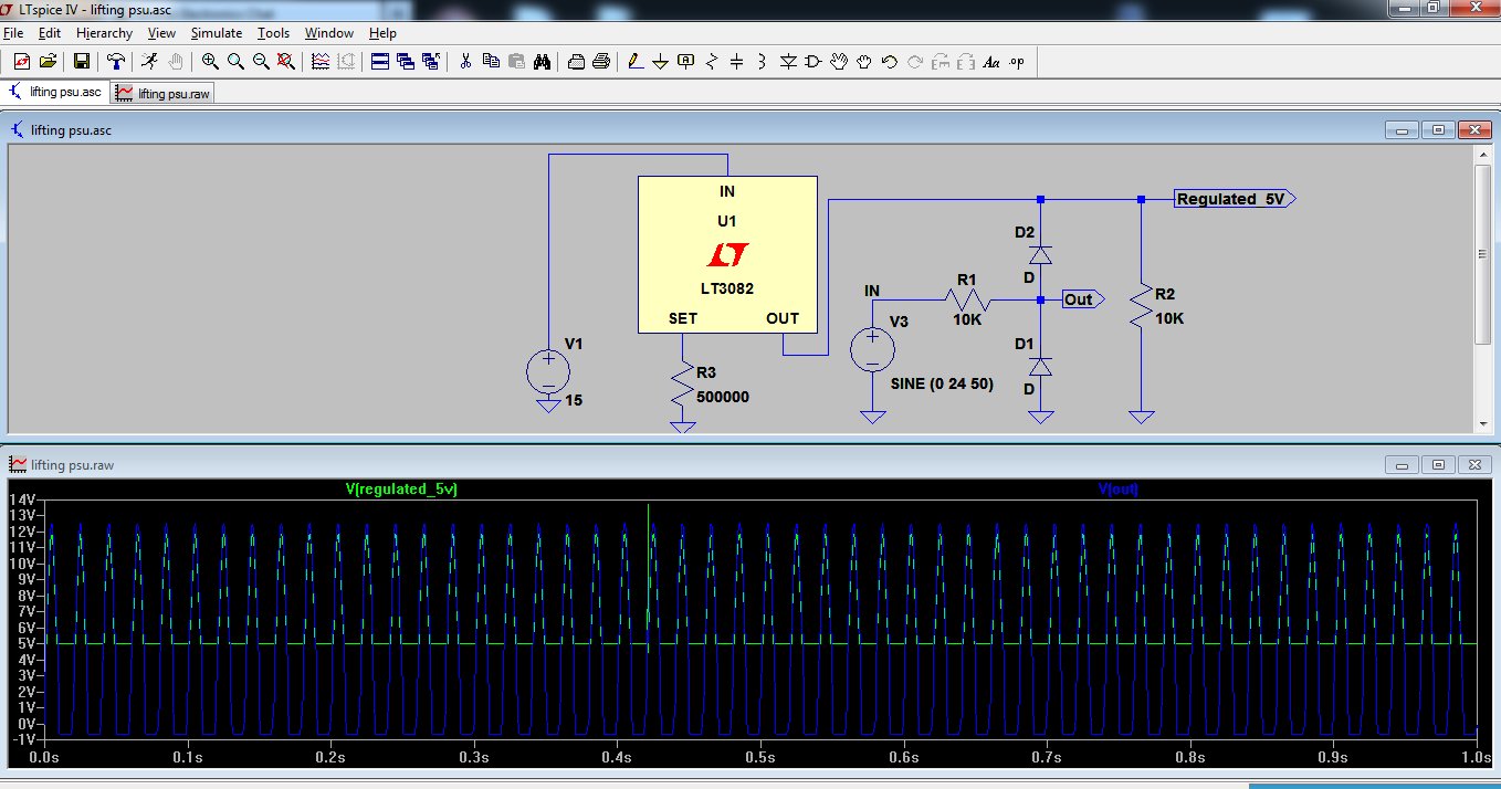

Really! If you look at my attachment (which I did simulate BTW) with a standard LT 5V reg you maybe in for a surprise. I am assuming your PIC draws much less than 3mA. It will do eventually with your circuit. Even if you did use a 317 (which I didn't see mentioned) with low value resistors, it's still bad practice.
Note how the 5V is lifted on the positive AC cycle even with a 10K load.
If you care to look at the internal layout of the reg, the PNP & NPN transistors go reverse biased when the output is lifted. It will more than likely take the regulator out too.

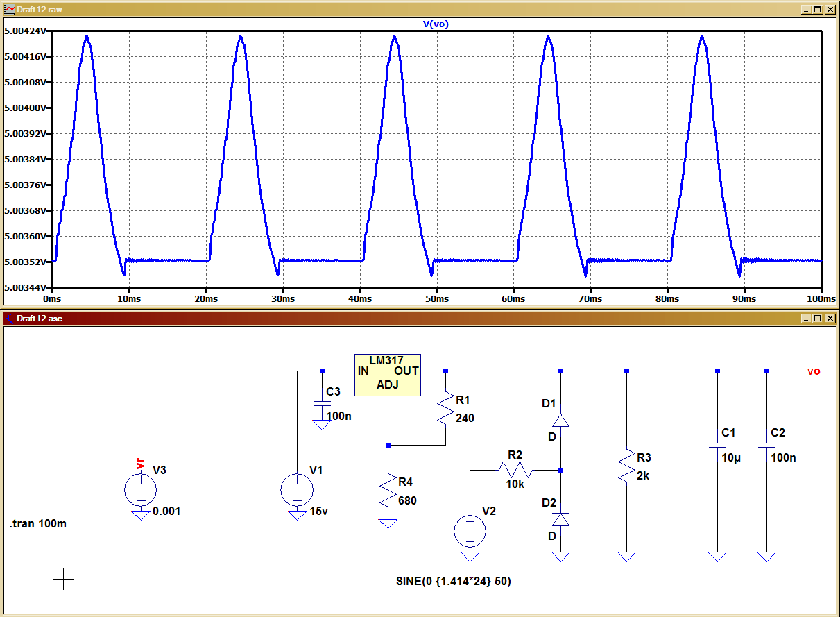

Looking at the OP's +5V reg , ie a LM317 which requires a minimum Iout of 3mA, plus the actual load of the Vset divider resistors of 5mA a more realistic simulation for the project would be as the attached image.
Which includes the required decoupling, this results in a 'spike' of around 1mV, which will not lift or damage the LM317.
