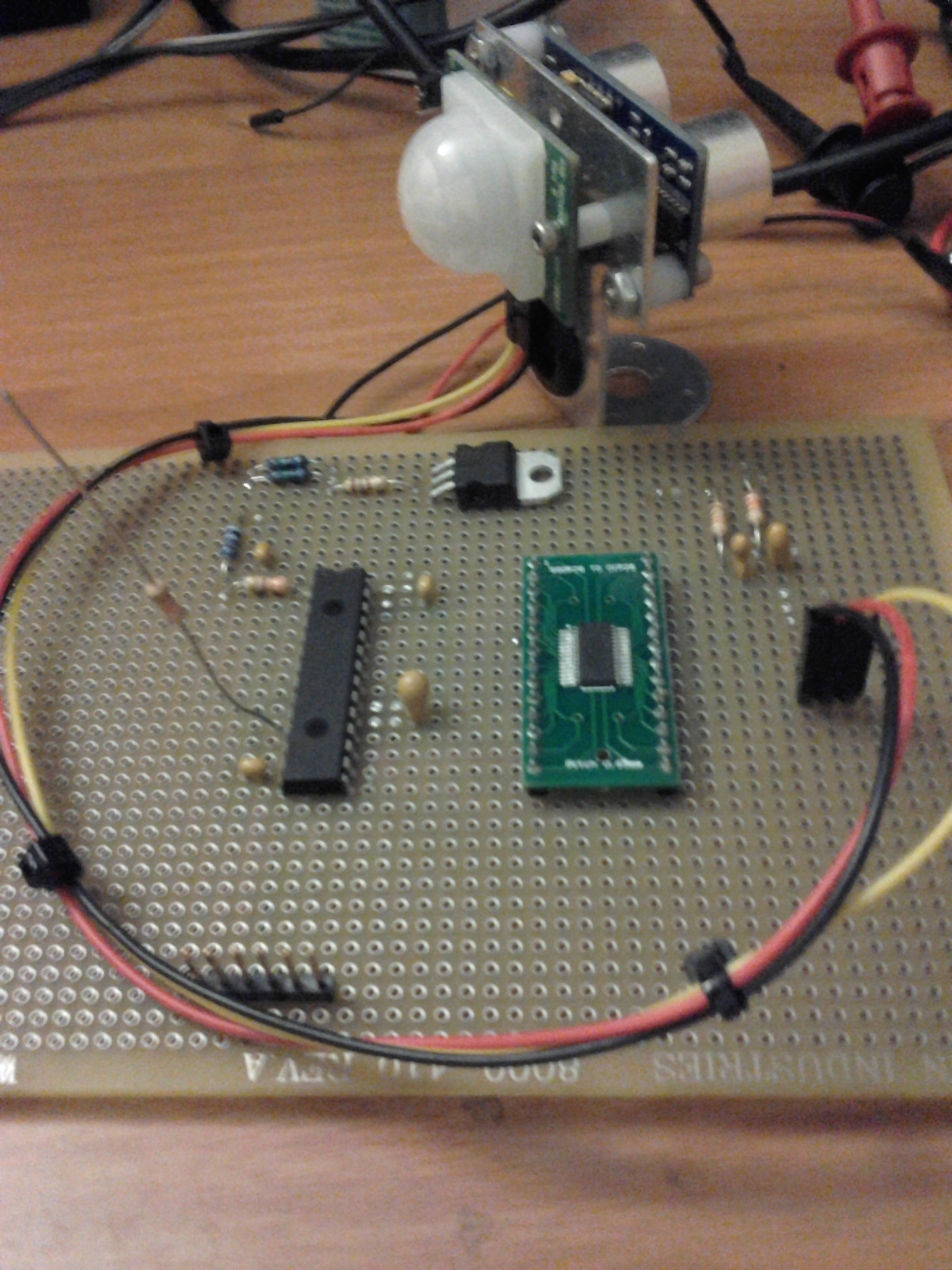

I tried a smaller motor stepper motor and still did the same thing as the big one. I've changed MS1 and MS2 to different setting and increased current with no success. I might upload a video to youtube of what the motor is doing. Also I'm using 3.3V for the logic circuit and thermal pad is not tied to ground right now, could that be an issue? Also the capacitor for VBBx I'm using is 47uF not 68uF as shown in the schem I posted. I kept on reading the datasheet of the A3979 and I gotta fix a couple of things.
I have the A3979 chip installed on a SSOP28 TO DIP28 PCB ADAPTER. This adapter then goes to a socket on the protoboard. This could in fact increase the resistance for the Rsense resistors. Maybe that's why I don't see any voltage across RS1 or RS2??? The picture I posted doesn't show the socket for the A3979 and some components are missing as this is an older picture.

You absolutely need to tie the thermal pad to GND. Odd behavior can occur if you don't!
Definitely upload a video with sound. You can tell a lot about what's going on by the sound of the motor.
So I connected the thermal tab to ground and didn't make much difference, but at least I got the thing spining now, maybe it did make a difference. The below code is what got it working. Notice in the video that I have three 1OHM resistors for RxSense. I'm getting the 0.2OHM 2W and 0.1OHM 2W Monday in the mail and will replace those. My Fluke DVM always reads the three parallel resistors as 0.4-0.5 maybe the leads resistance account for the error and they are 5%.
The problem I'm having now is that MS2 is not changing state, it's always low, don't know why, I checked at the pic and disconnected ms2 wire from A3979 and still don't change state when I run the code with ms2 = 1; or ms2 = 0; it's always low. So for the code below MS1 was high and MS2 was low.
I have to work on the acceleration part. I'll see what I can come up with or if you have a pice of code I could try let me know. I uploaded a video. So far so good, I'm almost there, thanks alot to you guys for your help. I just need to get this running smoothly and I'm done.

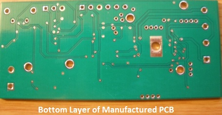

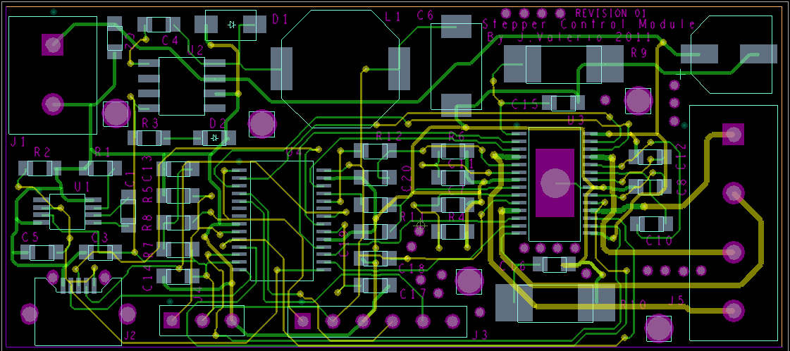

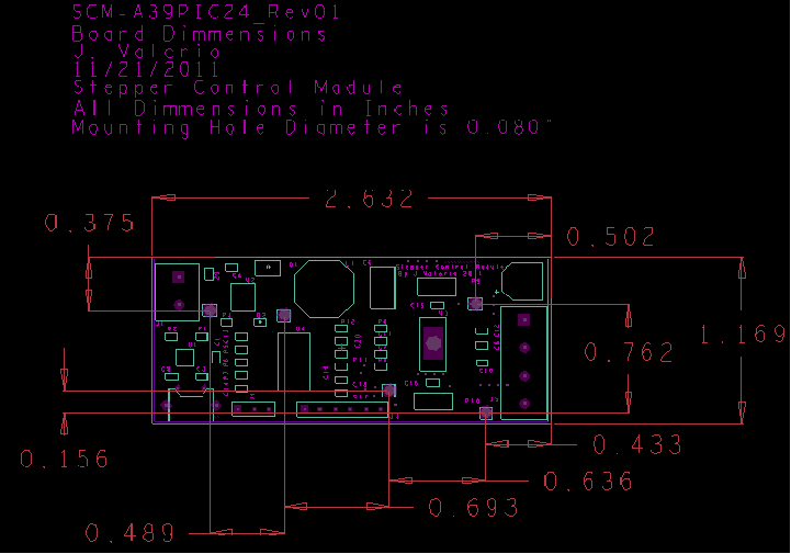

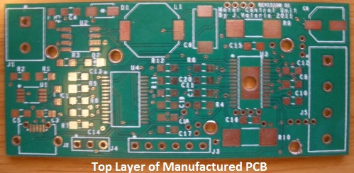

Hi guys.
I did end up building the board and installed all the parts.
The motor worked ok for a little while, but it then stopped working.
I think I killed the A3979 by leaving the current set at 2.5A. Will replace the A3979 tomorrow and see what happens. Here is the board I made. Any comments, critics, extra ideas are welcomed. Top and Bottom Layers are full ground plane to help with thermal and it's 2oz Copper.
