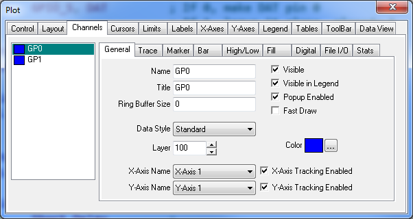

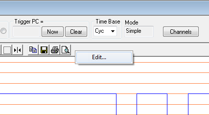

Maybe this is well known, maybe it's not. But there is this fairly odd, fairly obscure menu hidden in the Logic analyzer for MPLAB 8. The menu can be opened by right clicking the gray bar to the right of all the buttons, then clicking the non descript "Edit" text. And so far, that is the only way I have found to access it.
It looks very advanced, and it's also seems to be full of bugs, almost like it was a planed feature that wasn't supposed to be accessible yet, or behind the scenes MPLAB devs eyes only stuff, or an ester egg or something, IDK. I never really play with it, but it looks like it could be very useful. It's packed full of stuff. And I have always though the logic analyzer was somewhat lacking otherwise. Here is what the menu looks like.

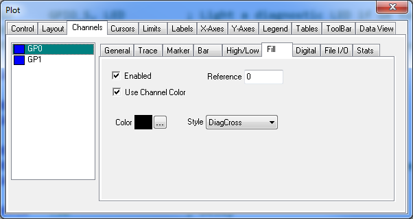

Anyway, here is an example of one of the options it has...

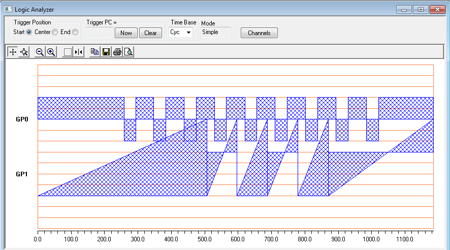

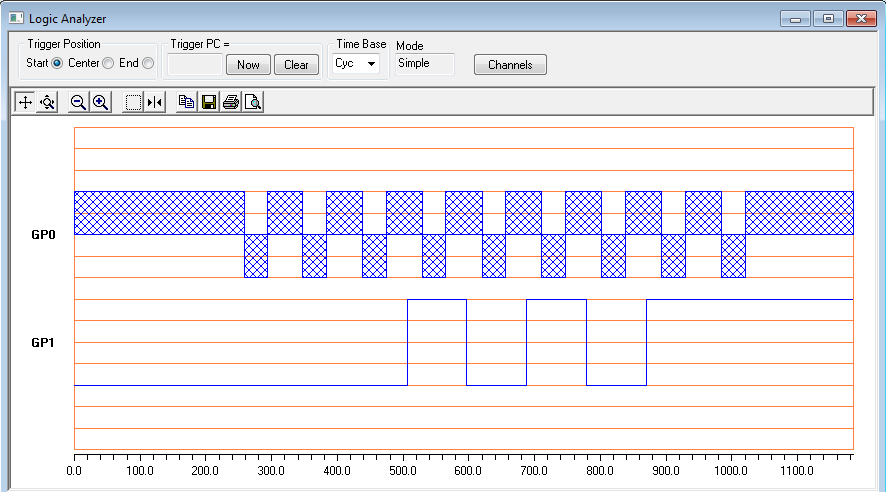

And here is the result...
And if you play with it, you will find that it is very buggy, here is an example of what happens when you try and move the fill reference level of the above options to try and make it so the fill is level with logic low.
You can see that the left corner of the fill gets moved down as it should, but the right corner stays in place and mucks everything up. This reeks of a simple bug where the dev simply missed doing the calculation for the other point. Half the other features are just as buggy also. Pretty interesting. The whole menu resets after you rebuild too, which is just as odd.

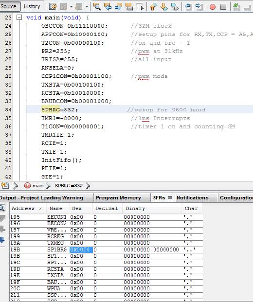

Just wasted a couple of hours tracking down a bug which turned out to be a typo/mplabx bugget. In the 12F1840 data sheet there is a sfr called SPBRG to set baud rate. Long story short, I just couldn't communicate with a bluetooth module. After checking everything I eventually got my scope on the problem. What should have been 9,600 baud was around 100,000 baud. Checked the SFR and discover that SPBRG contains 64 instead of 832 and is also called SP1BRG - SPBRG doesn't exist but MPLABX didn't report it as an error!!
This is what the disassembly looked like,
!    SPBRG=832;             //setup for 9600 baud
0x69: MOVLW 0x40
0x6A: MOVWF PR2
Go figure.
For 16 bit variables they have the low and high values and a combined 16 bit value. However, in this case the error was that xc8 accepted SPBRG as used in the datasheet but the name required was SP1BRG. The attached screenshot shows what I mean.
The above compiles even though SPBRG isn't defined anywhere (edit, well not by me).
