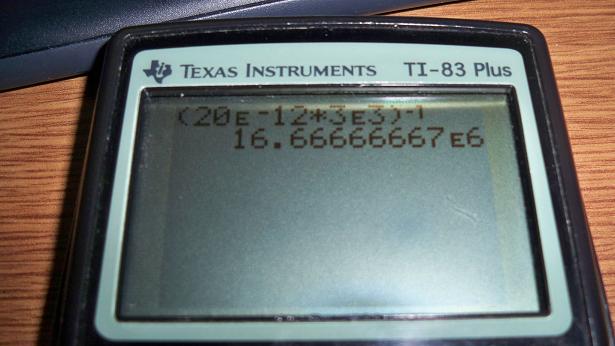

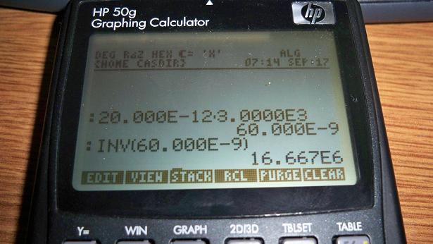

i get 16,666,666 only when i do:
2*10^-12 = 16mhz
20*10^-12 = 1.6mhz
Which one am i supposed to use
Look at the attached pictures on my post.
Well, the value of the capacitor is 20pF and so it is 20 x 10^-12. And, 3E3*20E-12 is around 16M. Post the calculation that produced 1.6 MHz.
Jason
I think that this is a function of the way you are driving the windowz calculator. I get the same result in Unix (ubuntu) as you are if I do 20*10e-12 (because this is besing expanded to 200e-12), however if you do 20e-12*3e3 (and then do 1/x) you get the correct result. In fact I could not get in to work in Windowz at all!
