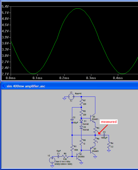

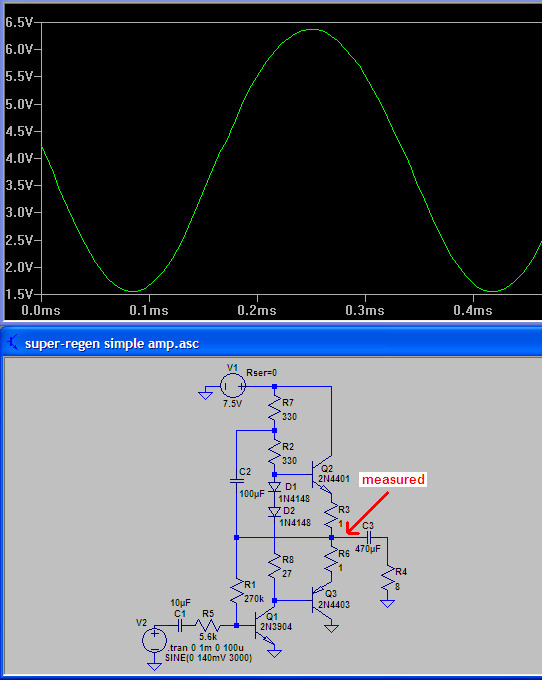

The circuit is designed for 4W output so it uses a high supply voltage and many transistors for high current. A 0.4W amplifier would use a lower supply voltage and only 3 transistors.
0.4W RMS is a peak-to-peak voltage of 5.1V and a peak current of 318mA into 8 ohms.
If the amplifier has a power supply voltage of about 7.5 V and the output transistors are 2N4401 and 2N4403 then the max RMS output power into an 8 ohm speaker will be around 0.4W.
I simulated it. It has only 3 transistors so its distortion at 0.4W is about 10% and is lower at lower levels. Its voltage gain is about 18.
The 1 ohm resistors add voltage to the base-emitter voltage of each output transistor so that there is less difference in current between transistors that have a 0.65V base-emitter voltage and transistors that have a 0.68V base-emitter voltage. You want about 15mA in the output transistors to reduce crossover distortion and 10mA in 1 ohm is a voltage of 0.015V.
Without the 1 ohm resistors, some output transistors that have a low base-emitter voltage will have an extremely high current all the time.

unfortunately we cant get hold of any 3.2ohm speakers, the only suitable ones are around 7ohm to 8ohm
would the circuit still work with something like these?
thanks for your help!

I forgot about the 3.2 ohm speaker.
I reduced the values of some resistors so that more current can flow, increased the value of the output capacitor and decreased the battery voltage.
Now the amplifier provides 420mW into 3,2 ohms.

I also haven't seen 3.2 ohm speakers for about 30 years. You must have an old text book.
The amplifier needs to be designed for the load. My 400mW amplifier that I simulated has an 8 ohm speaker.
Your original post said 3.2 ohms, which is highly unusual these days. audioguru designed a circuit that works with 8 ohms. Now that you are changing to 8 ohms, the original circuit is perfect.
The leading cause of redesigns is inaccurate specs.

The amplifiers I simulated are class-AB because the output transistors have about 15ma of idle current.
The 1 ohm resistors even out the huge spead between the base-emitter voltage of different transistors.
Without the 1 ohm resistors then the output transistors will either operate in class-B with high crossover distortion or in class-A with a high idle current and lots of heat.

The amplifier circuit I simulated with the 8 ohm speaker has a voltage gain of 18. Its output voltage at 400mW is 1.79V so its max input voltage is 1.79V/18= 99mV.
A microphone has an output level of from 2mV to 10mV so it needs a peamp with a voltage gain of at least 49.5.
