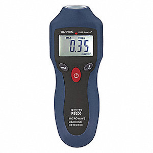

i have used a real microwave leakage tester. if everything is properly assembled, the leakage from the cavity, waveguide section and magnetron are only detectable with the top cover removed, and even then it's well below safety limits. the only time i have ever seen measurable leakage from an oven was one where the cavity (the oven itself) had been visibly deformed from the unit being dropped. your co-worker's "EMF" meter is just picking up magnetic noise from the AC power lines, and not RF, and certainly not 2.4Ghz leakage from the oven (which actually requires very low capacitance diodes to measure). a real microwave oven leakage tester has a very distinctive cone-shaped pickup and the purpose of the cone shape is to get the antenna the proper distance and orientation from the surfaces and seams being tested.

Here a pic of a real tester tho

Determining the radiated field strength of a microwave oven is not a simple task, not nearly as simple as pointing a field strength meter (of any kind) at it. Devices are placed inside a shielded room or cage (sometimes called an anechoic chamber, although that is only one of its required properties). A high-gain antenna is pointed at the device, and a receiver and spectrum analyzer show the field strength at whatever the frequencies of interest are. The test is repeated for each of the six sides, and development testing includes focusing on the hinges, door seals, and the screen in the front door. Yes, the screen leaks a little bit; ALL shields leak (see above), which is why it is so carefully designed and verified.
The hard part about testing is making sure you are measuring *only* the device, and not the building security system or wifi (which almost certainly are in the same frequency band). This is why amateur on-site testing is (almost) by definition of low or no value.
