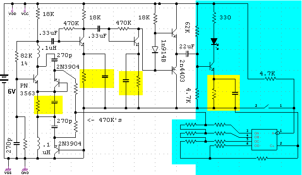

I am getting somewhat confused.
A number of you have seen my story on my superregen receiver posted here in different threads over the past few months, and a number of you have made good suggestions.
So after I realized that my design had distortion at loud volume, I thought I should take a different approach similar to what a number of you recommend.
In every amplifier stage, except for the power amplifier stage, I have added a 4.7K resistor and a capacitor in series to form the "miller" circuit.
It seems that the sound quality is much better, but the volume is a little bit reduced.
I have chosen resistor values based on the voltages at the base of each NPN transistor.
I think that the emitter current and collector current must be the same for optimal transistor operation.
I am going to try to choose different value resistors to obtain more gain.
Right now, my detector has an 18K pull-up resistor, an 82K 1% resistor from base to the 18K pull-up resistor, and a 4.7K resistor between emitter and the tank circuit that is connected to ground.
The circuit won't work if the voltage is under 6. It will work at 3V if the pull-up is changed to about 10K.
I plan to decrease the pull-up resistor, but I want to know my limits before creating component "bombs" (you know, circuits that blow up when they start). Also, I want to make the amplitude larger, and I'm afraid if the 82K resistor goes too low, then I think the gain will go too low.
The transistor I am dealing with is a Pn3563.
I'll see what I can personally come up with
I intend to add 10 or more uF bypass capacitors to the 4.7K resistors.
the circuit is shown below. The parts in cyan (turquoise) are what I intend to deal with much later. The parts in yellow are what I need help with.
Right now all my resistors highlighted in yellow are set to 4.7K and the capacitors next to them are set to 0.33uF.
I also added a 270pF capacitor between the left-most 18K pull-up and ground.
I am able to pick up CH-TV (air channel 11), but the volume is too low. (lower than if I shorted each miller effect circuit). The yellow circuits are the "miller effect" circuits.
If I remember, electronics-tutorials.com claims that the emitter resistor is calculated as follows:
<base voltage> - 0.65 / <current of collector>
Now my base voltage happens to be substantially high, because the lowest value used for a pull-down resistor is 470K.
The collector resistor is 18K.
If the collector current and the emitter current are supposed to be equal, and my thinking is correct, then the emitter resistor must be close to the collector resistor, or I strain the base by adding a pull-down resistor that is lower than 82K, and if I do that, wouldn't my gain be cut greatly?
so what I was wondering is, how can I achieve the highest gain (or audio volume) with the least distortion?
The 22uF connected to the cyan part is for now connected to the speaker. Instead of 22uF, I am testing with 1000uF.
I still think I should lower the resistors in yellow, because making the capacitance value too high will just waste board space.
Perhaps you read about 'miller effect' somewhere, and liked the sound of it?.
Those components aren't anything to do with 'miller effect', they are simply bypass capacitors for the emitter resistors - bypassing them in that way increases the gain, by reducing the negative feedback around the transistor. All altering the value of the capacitor will do is alter the amount of bass, reducing it as the capacitor gets smaller.

Nigel Goodwin said:
The yellow increases the gain, by reducing the negative feedback around the transistor. All altering the value of the capacitor will do is alter the amount of bass, reducing it as the capacitor gets smaller.
That's weird, because when I tested it, I didn't notice an increase in volume. The circuit I explained above produced a clear audio signal, but at a ridiculously low volume.

Russlk said:
That is a wierd circuit!
It is not a final circuit.
Is there an input somewhere?
I can connect an antenna to the Pn3563's emitter. or I can connect the antenna to +ve, which provides somewhat better reception.
What are those diode-connected 2n3904 doing?
The 2n3904, and the capacitor connected to it make a poor-man's varactor I'm using 2 of them and connecting their inputs to the same source through resistors, so that I can gang-tune my circuit without the need of two separate trim capacitors.
I assume this is a superregen receiver, where is the antenna?
I forgot to include it in the circuit, but I can still pick up the TV station without an antenna!

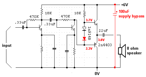

Your audio amp leaves a lot to be desired if you want low distortion:
1) If it has an 8 ohm speaker then with only a 6V supply, its max output power at clipping is only 1/4W.
2) With only 22uF feeding the speaker, frequencies below 909Hz are cutoff.
3) With 18k as the base bias resistor for the NPN output transistor, it can rise only 0.25V from an idling voltage of 3V, because an 8 ohm speaker needs much more current than the current gain of the transistor can supply with an 18k base resistor. It would be much better with a 2.2k resistor but then the voltage gain of the driving transistor would be reduced. It should have a bootstrapped resistor for high gain and low distortion.
4) Only a single diode is used so the output has crossover distortion from a single transistor.
5) The amp doesn't have overall negative feeddback.
