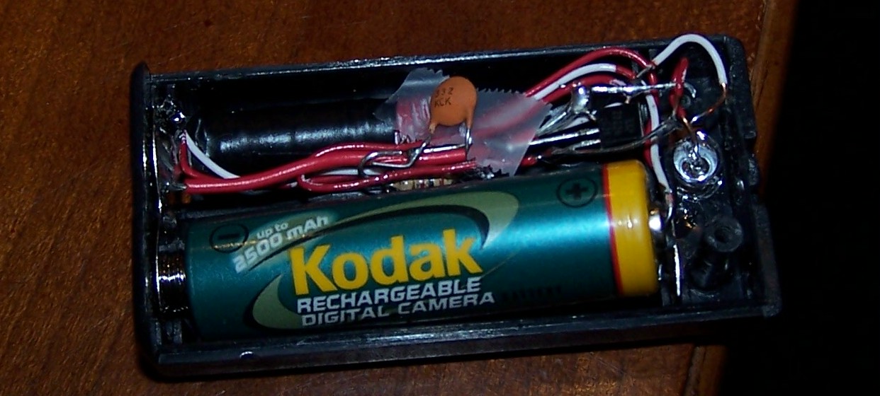

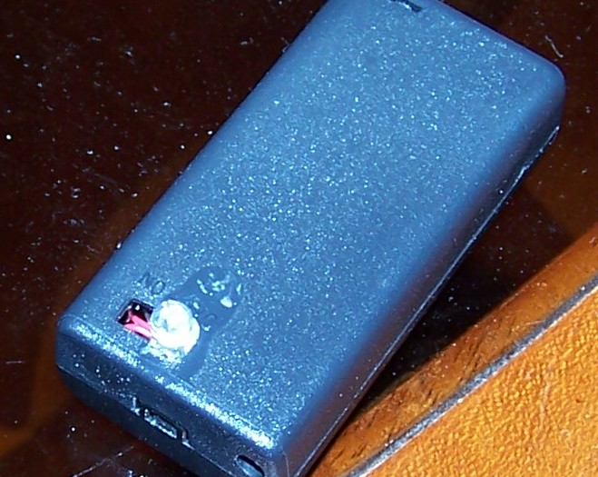

Here are the pictures:
The LED was so bright it messed up my camera's automatic brightness adjuster. It is a 2000mcd white LED.
1523: The inductor coil in background, with circuitry in forefront.
1521: The finished product, the LED was on but was so bright I had to take out battery to make sure it diddnt damage the camera
1525: Another picture
It works really great, and it has a project spot on my website.

I don't see your inductor.

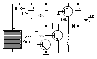

My solar garden light has an inductor the size and shape of a little electrolytic capacitor. It is about 5mm long by 3mm in diameter.

It is the black thing in the background. It is homemade and tightly wrapped. It looks really good. if you look to the left of the capacitor, you can see the red and white wires of it.
