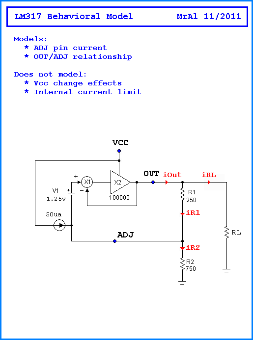

I'd appreciate if you can give me what you called 'behavioral model'. Really thank you for your lots of help.
Hi again,
The model is shown in the attached diagram.
The parts are as follows:
X2 is an amplifier with a gain of +100000
X1 is a subtractor (summing junction with one inverted input)
V1 is a 1.25v battery (reference)
The "50ua" is a 50ua current source
The terminals of the LM317 are labeled:
VCC, OUT, and ADJ as per the device.
The currents shown are:
iOut: This is the total current out of the device, this must be at least 5ma (or 10ma depending on real world device)
iR1: Current through R1
iR2: Current through R2
iRL: Current through the load resistor RL.
From this model we can see that iR2 is equal to iR1 plus 50ua.
We also see that iOut is the sum of iR1 plus iRL.
This model can be used to better understand how the LM317 works inside without knowing all the details, however
it can not be used to analyze the current limiting function nor how the changes in Vcc affect the output. Since
our main concern in this thread is the minimum output current, this model is appropriate. It can also be used to
understand how the bias current (50ua) can change the output with temperature, but that's not important right
now.
