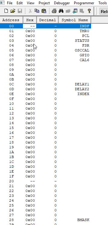

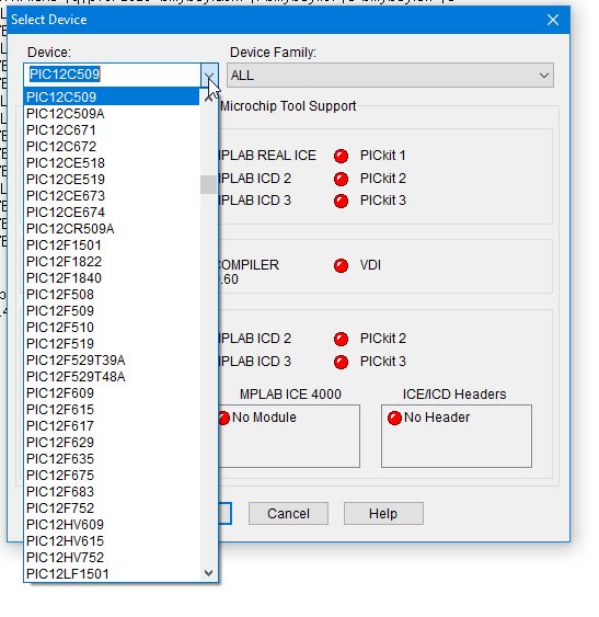

Yes, just found that when I built your code, though the 12C chip is the one time programmable chip, you need to change the LIST and Include lines to 12F, which will build ok and then allow you to your your Pickit programmer.
You also need to Configure, Select Device and change the 12C to 12F
If you View, File Registers , you will see what those variable are.

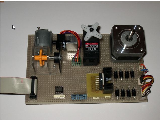

Personally still prefer to build and test my own hardware, for motors I made up a board with a couple of different types of motrs .stepper, servo, all just a few pound from a local hobby shop or online.
Just looked back about 8-9 years ago to find the motor board and assembly code I used, driven by the L298 motor chip which you can buy as a complete driver module for just a few pounds on the usual uk sites
Though using a larger chip, the 18F, it does contain some extra routines you might find of use in the future.

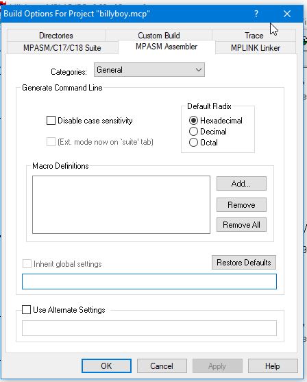

This is probably a dumb question, but what does the B in the line
EQU B'11000000'
mean?
Is it to denote a binary number, or is it a bank/register?
Google has not helped to answer this.
Yes, typically you see "b" lower case, but it depends on the assembler build settings, you have various options from the menus, like Case Sensitivity and Radix
OK, so I've managed to compile this code, but it doesn't run properly in MPLAB X simulator.
(Very steep learning curve.)
I am able to toggle the run/stop GPIO 3 and direction GPIO 5, but GPIO 0 only ever goes high and stays high.
I'm not sure what is happening with the ADDWF PCL, F as it doesn't seem to produce the output pattern to drive the ULN2803.
I've also run the program in the Oshonsoft simulator (great software by the way) with the stepper motor option and it only clicks to one pole then stops.
Can anyone suggest what to try? Where have I gone wrong?
