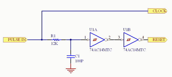

I'm not good with analog (more of a software/digital guy), but I know there's a circuit that can generate a specific width pulse on the leading edge of a pulse. This would convert my 50% square wave into a train of pulses of equal width no matter the frequency.
Anyone know what that circuit is called and how to make one?

It's called an edge detector. You can just use a series capacitor followed by a shunting resistor to ground; but for a cleaner signal, this should be followed by a schmitt trigger.

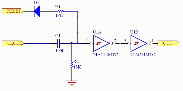

Likewise, the receiving end is a resistor followed by a capacitor to separate the reset pulses out from the clock. The schmitt trigger is optional, but may improve the function.
Have a look at the attached schems. The component values may be wrong, they they should be a start.
If you don't use buffering (e.g. the schmitt trigger) on the sending circuit, you'll have to more careful with the receiving end - the cap in the sender should be >> than the cap at the receiver.
