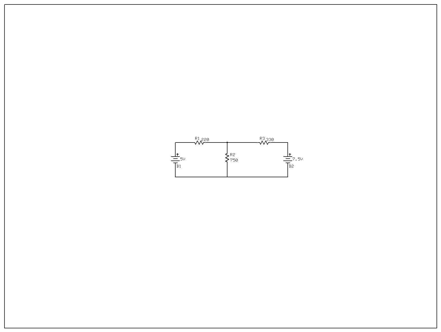

here is the superposition schematic:

It's a little hard to guess on the diagram you posted because you didn't provide the values you got.
there seems to be some confusion, the missing voltage and the superposition are 2 different isues, sorry i should have been more clear.
There's no confusion on my part Dragon. You said you were having a mismatch from the observed and calculated valueson the superposition circuit... You gave no expected or measured values or how you came up with them.... Just a circuit with two batteries and three resistors. Seriously, are we supposed to guess? =)

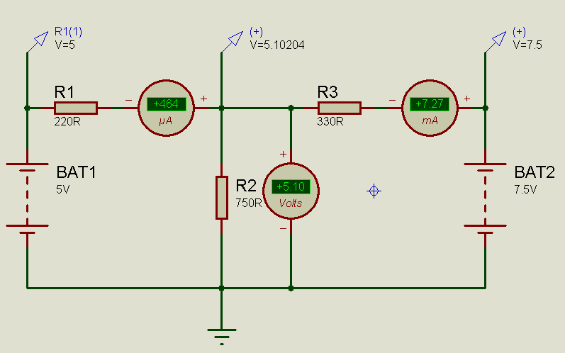

off the top of my head the current value thru R1 should be something like 400mA, yet when i measure it i get something like 136uA. everybody i ask is stumped by it.
The current through R1 should be approximatly 464µa so neither of the values you mentioned make sense.
Here is the simulation result.
It says exactly the same as Sceadwian: Current flow across R1 is 464µA.
Using a pocket calculator it only says the truth if results are roughly estimated prior to calculating. :D (error of 1:1000)
