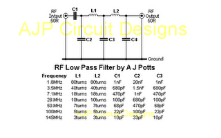

I take issue with that statement as well. most lo, hi, band pass filters I have ever seen all have C's and L's :)
an example....
rf_lowpass_filter-png.52222
cheers
Dave
an example....
Hmm, maybe that's because you work out there in RF-land, where everything is weird (every piece of wire becomes an inductor, etc.).

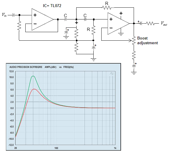

I use an active second-order highpass filter with a high Q so that its resonance makes bass-boost then a sharp dropoff for my stereo system.
I use an active second-order lowpass filter with a high Q so that its resonance makes treble boost then a sharp dropoff on telephone confrencing systems.
They don't use inductors.

It's common to refer to peaking in filters as "resonance" whether the filter is LC or active. Just because this use of the word doesn't fit in your narrow definition doesn't make it wrong, "plain and simple" or otherwise.
You and "Hopelessly pedantic" can live in your own little world of narrow definitions if you like, but that doesn't mean they are absolutely right, or that the rest of us have to be confined by them..
Rooms and halls have resonances and they don't have inductors. Even a pop bottle has a resonance. Musical instruments?
Yes, they do, being complex mechanical systems with the equivalents of L and C elements. But your filters, mentioned earlier, do not have resonance, so that term is misused there.
Please explain to us how those filters have resonance. Show your work.
Show your work.
I designed my bass boost circuit long before this Australian guy published his circuit on the web but they are the same. Maybe he copied mine.
The circuit is an active second-order highpass filter with positive feedback higher than a flat Butterworth filter so it has a resonant peak.
