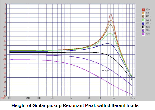

My Bass Extension circuit has a Q and a peak exactly like an LC filter. The amplitude of the resonant peak is adjusted with the gain control on the highpass filter because it adjusts the amount of positive feedback through the feedback resistor. If the gain exceeds about 2 then it oscillates.
In google there is a link to an article about a guitar pickup resonant peak with different loads. Its LC resonant peak looks exactly like my bass extension circuit's resonant peak excent its frequencies are reversed.

Well, OK, I'll admit that at least that top curve looks like a classic resonant peak, like that of a fairly highly selective L-C filter. But then again, it doesn't look much like the response of a typical low-pass filter either, which one certainly wouldn't expect to be that "peaky".
Normally, that "peak" would be the FC of the filter. Where does that peak come from?

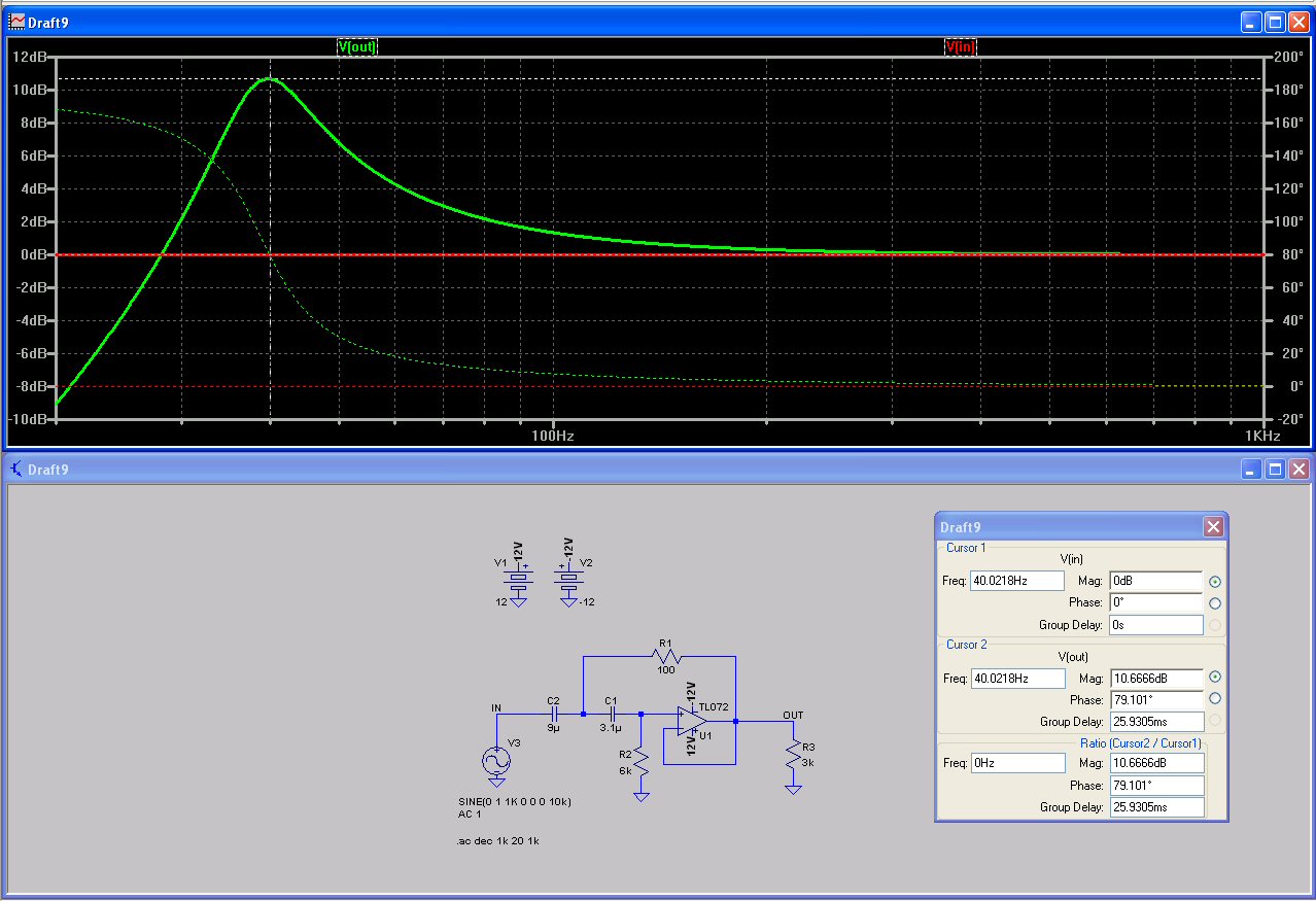

Actually, I think you are confusing an underdamped filter response with resonance around the corner frequency. What you stated in your post #13 sounded exactly like a Chebyshev response, which does employ degrees of underdampening. From your graphic, that seemed apparent. Unfortunantly, the phase response was not included to confirm this.
I set up a simulation of a simple but grossly underdamped 2-pole highpass Chebyshev that closely approximates the response of your circuit at the highest peak of ~10.5db. With a phase shift of just 79deg, it would appear to be a relatively stable system lacking the possibility of becoming a resonator.

Your resistor and capacitor values are much too low for a TL072 opamp to drive. But your response curve looks the same as mine.
