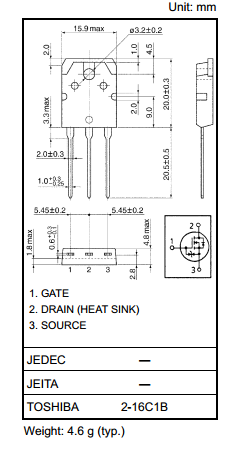

Go to your post #7. Look at the mosfets. When they are positioned as shown, the pins at the bottom are named, left to right, Gate, Drain, Source. The gate is what turns the mosfet on. The Source is (should be) at a lower potential than the Drain. Here's a picture from the datasheet:
Referring back to the picture you posted, there is a resistor to each gate. The other end of that resistor goes to a gate drive. That is, the IC, transistor, or transformer that provides voltage to turn on the mosfet. You reference a "PWM chip" in post #22. The PWM chip often includes the gate driver. Regardless of what the driver is, if you measure the voltage at the drive resistor relative to the Source pin, it should be about 8 to 12 V peak to peak, Your voltmeter probably won's show that, but it should show some voltage. If there is no voltage at the gate, then the mosfet won't turn on. Trace the circuit from the gate resistor just described to the PWM chip. Try to draw it out and post the picture here.
