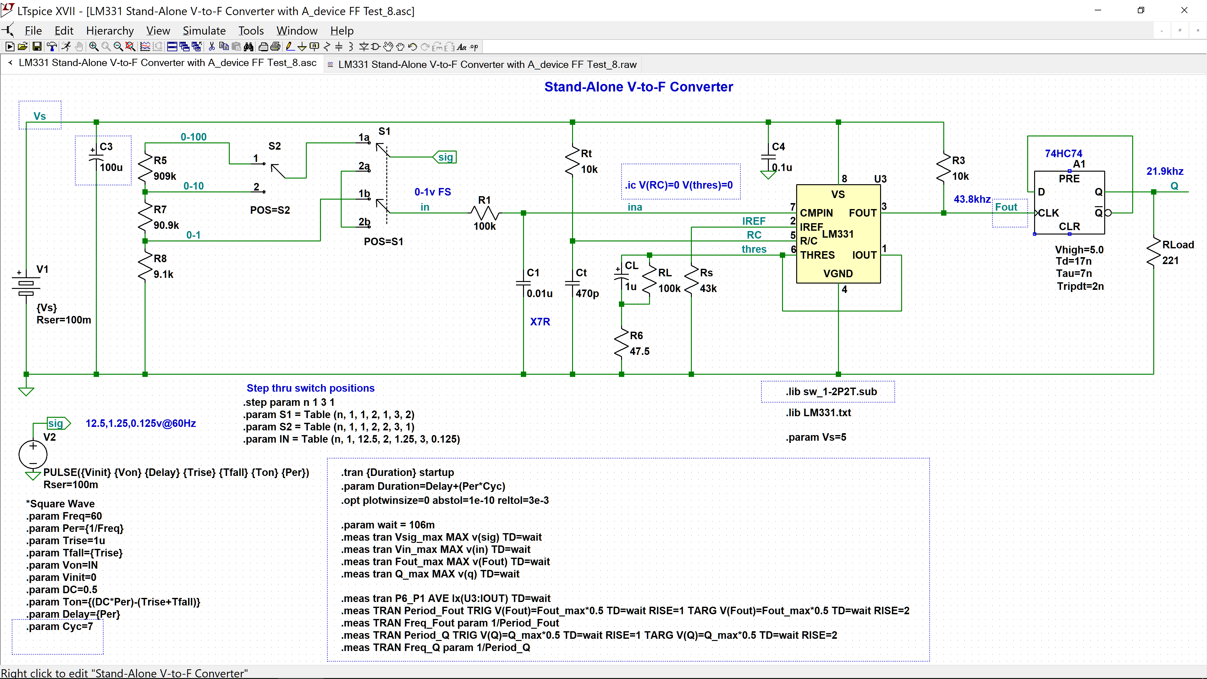

Model of LM331 for LTSpice
Simulating the pot is no problem.
Please provide your concept of simulating the 1M pot to sense from the Standard 0-1v DC range, to higher 0-10v, 0-100v DC ranges, etc., utilizing its switch. When the switch is OFF, the pot's output to V(in) should be at 1M. Once I see a simulating the pot visual plot, parts will be ordered.
link
Finally, can LTspice export the net-list, so the design can be used with Eagle PCB?
Thanks for helping get simulation functional!

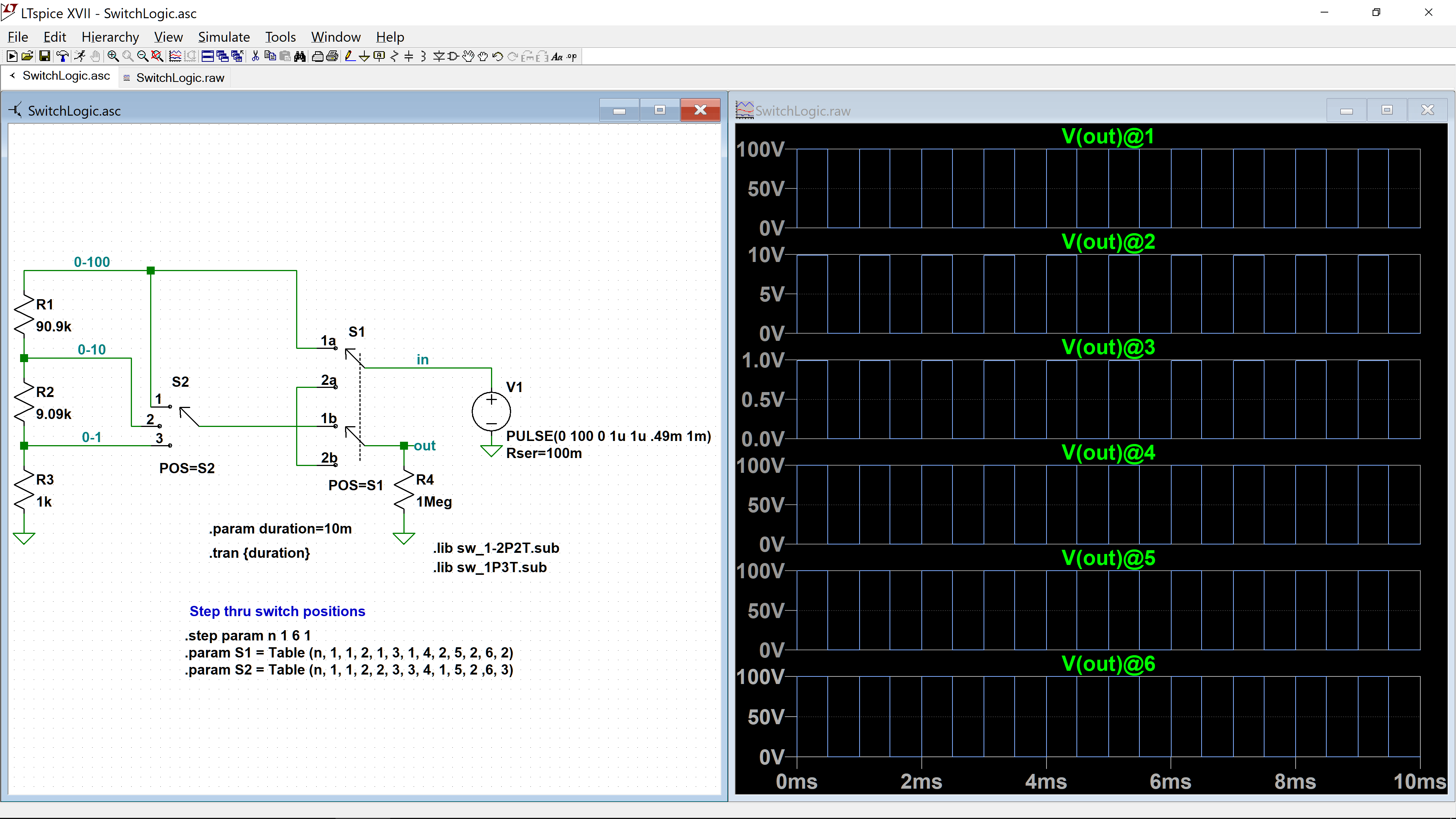

Frankly, I still don't know what your trying to design.
My goal is to design a poor man's, software driven, digital storage scope.

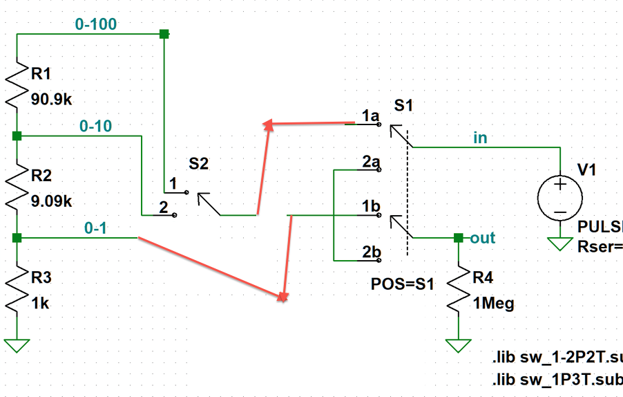

I have attached the resistive voltage divider front end to the LM331 circuit.
S1, S2, S3, S4, V3, V4, R7, R8 & R9 have been added.
All switches need to be normally open and closing S1, should simulate as before and was fully functional. Opening S1 and closing S2 & S3 increases full scale sensitivity to 0-10v. Opening S3 and closing S4 should now increase full scale sensitivity to 0-100v DC.
Since this is my 1st attempt at simulation, I need help getting LTspice to independently turn ON/OFF the 4 added switches LTspice calls 'Voltage Controlled Switch'.

Very close, see attachment . . .
Rotary Switch model attached. Place the files in the same folder as your schematic.
Add the symbols and statements as shown.
  • sw_1-2P2T.zip
V(q) must not vary +/-5% between each scale setting!
By increasing R7, R8 & R9 by a factor of 10, V(q) linearity is lost in simulation, please confirm on your rig:
R7=1k, R8=9.09k, R9=90.9k

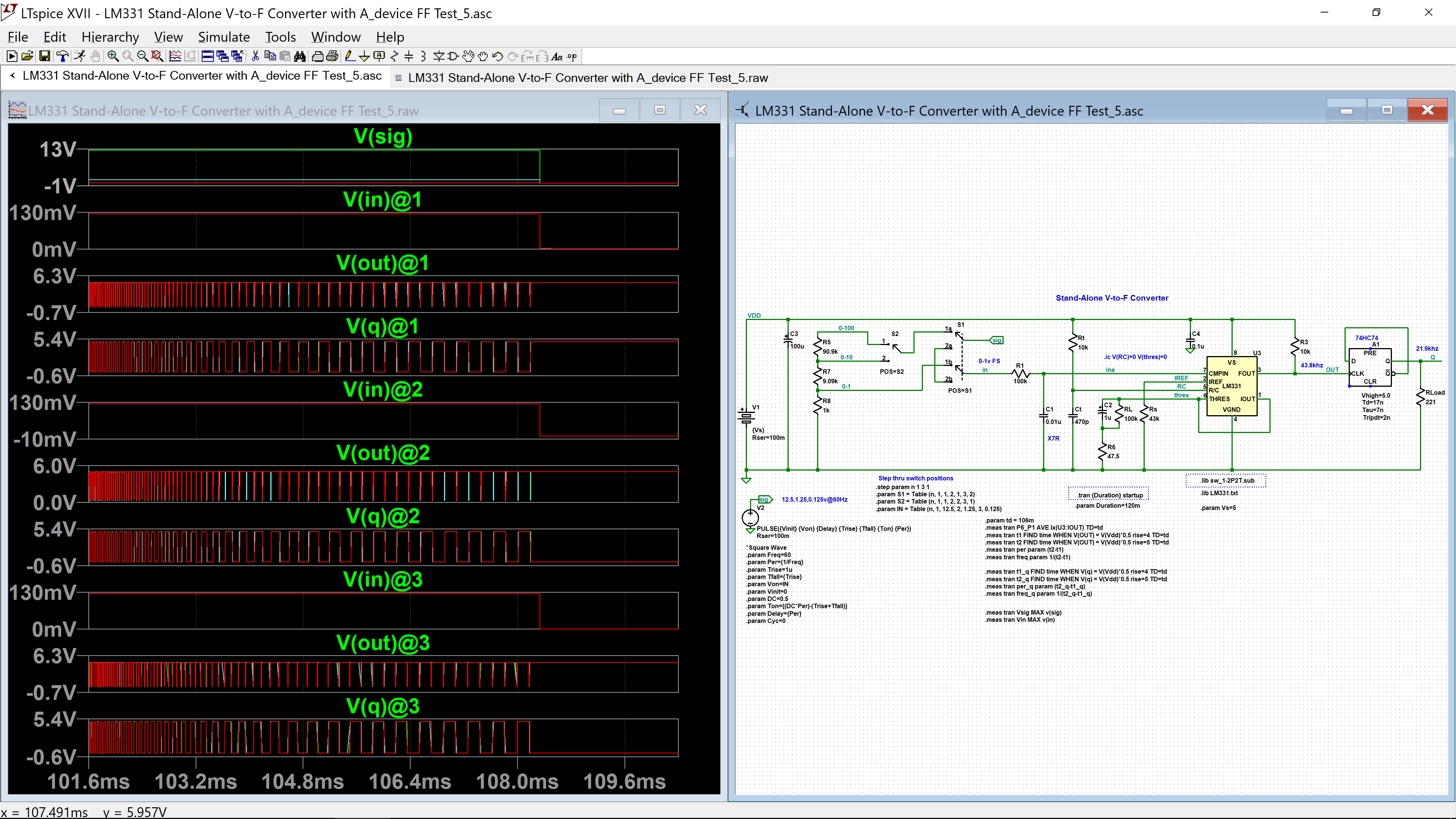

0-1v in:
p6_p1=0.035 FROM 0 TO 0.035
t1: time=0.0321415 at 0.0321415
t2: time=0.0323274 at 0.0323274
per: (t2-t1)=0.000185933
freq: 1/(t2-t1)=5378.28
t1_q: time=0.0328846 at 0.0328846
t2_q: time=0.0332561 at 0.0332561
per_q: (t2_q-t1_q)=0.000371491
freq_q: 1/(t2_q-t1_q)=2691.85

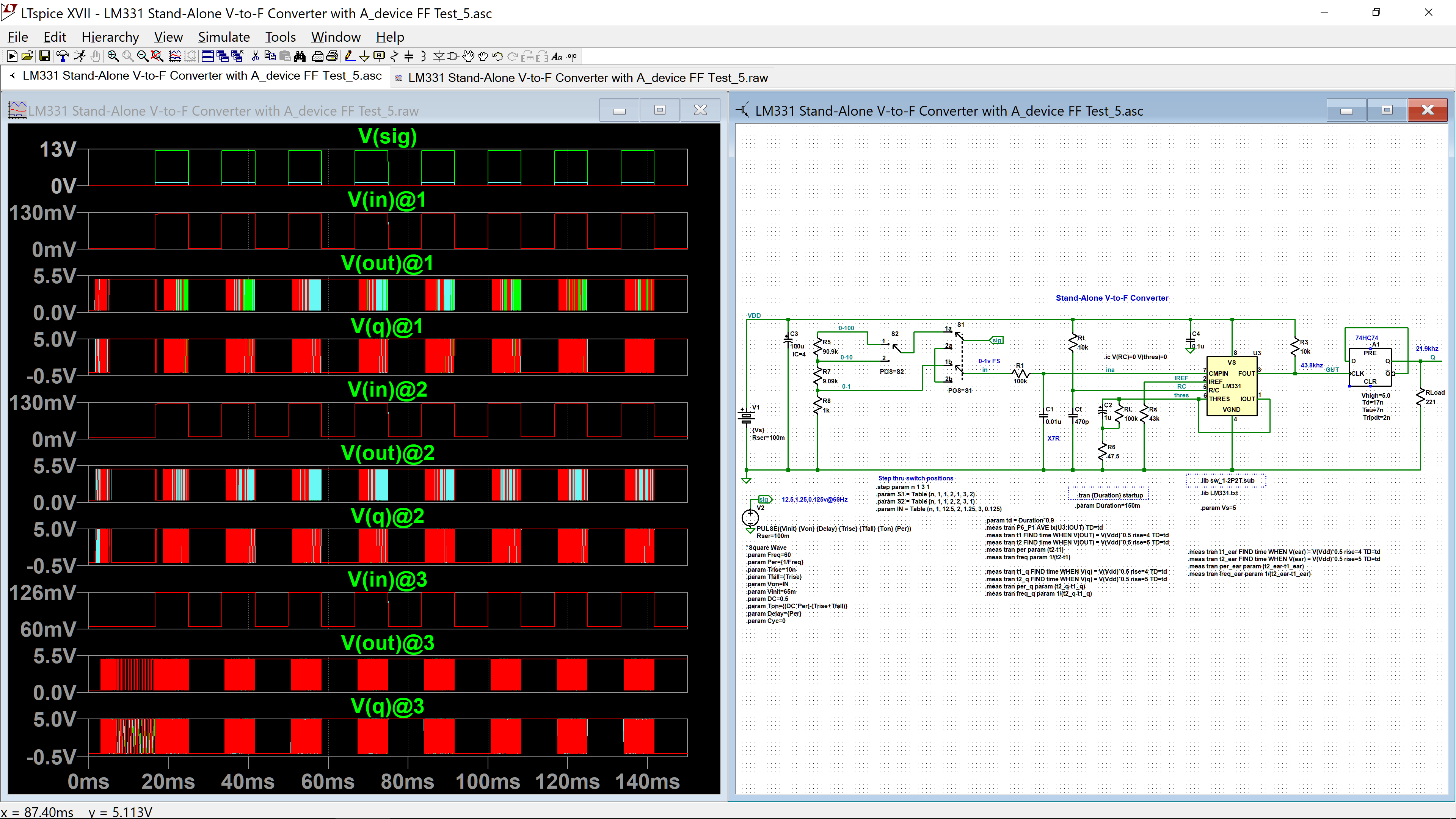

0-10v in:
t1: time=0.0321107 at 0.0321107
t2: time=0.0322966 at 0.0322966
per: (t2-t1)=0.000185896
freq: 1/(t2-t1)=5379.34
t1_q: time=0.032669 at 0.032669
t2_q: time=0.0330415 at 0.0330415
per_q: (t2_q-t1_q)=0.000372448
freq_q: 1/(t2_q-t1_q)=2684.93

R7=10k, R8=90.9k, R9=909k
0-1v
t1: time=0.0321396 at 0.0321396
t2: time=0.0323254 at 0.0323254
per: (t2-t1)=0.000185809
freq: 1/(t2-t1)=5381.87
t1_q: time=0.0328827 at 0.0328827
t2_q: time=0.0332541 at 0.0332541
per_q: (t2_q-t1_q)=0.000371394
freq_q: 1/(t2_q-t1_q)=2692.56
0-10v
t1: time=0.0321531 at 0.0321531
t2: time=0.032327 at 0.032327
per: (t2-t1)=0.000173884
freq: 1/(t2-t1)=5750.96
t1_q: time=0.0328487 at 0.0328487
t2_q: time=0.0331965 at 0.0331965
per_q: (t2_q-t1_q)=0.000347771
freq_q: 1/(t2_q-t1_q)=2875.45

Provide your input signal level vs scale settings to use for tests. So we work from the same test values.
Please post your '.asy' battery symbol 'V1' you use in schematic . The LTspice mac version lacks it, along with tool bar/ help menu.
Also, is there a part number/visual for rotary switch S1?

Which divider values are you going to use? Otherwise, you can make these changes yourself and rerun the tests.
The battery symbol is in the Misc symbol group.
There is no part number for the rotary switch. You'll have to find one.
In addition to the LM331 model, you are using a FF that does not exhibit all the behavior of a real FF.
Keep in mind, you are probably at a point where you'll need to do further testing using real hardware.
Simulation is not a replacement for that.

Updated schematic, using functional divider, as indicated.
Also, I don't see a node labeled 'ear' in schematic that's mentioned in the added '.meas' directive's.
Please interpret attached error that gets flagged after hitting run . . .
  • V-F_Divider_ERROR.pdf
specify the model name in the “Value” attribute of each switch symbol.
sw_1P2T
or
sw_2P2T
as appropriate for each switch.
Increased divider values showing stable 'freq', but unstable 'q'. Shouldn't 'q' be exactly half 'freq'?
Log show's 'q' error's, too, so would you know the cause?
I added a transistor to gain the forward voltage drop across emitter-base, to give 'ear' a boost. Changed Vhigh to 4v, TTL level.
Finally, I corrected a miss-wire in your schematic, unless this was intentional.
  • LM331_Stand-Alone_V-to-F_Converter_Test5v-vd-sw-ear.zip
In theory, yes. but the calculations are based on the output period which includes variances like rise time. So there will be a slight difference. This is why you need to test this in hardware.
I don't see any errors in your log file
Be aware that the actual output level of a real FF device will be based on the supply voltage and will be slightly lower than the supply voltage. Check the FF datasheet.
BTW- 74HC operates at CMOS levels. 74HCT operates at TTL levels.
My schematic is correct. RL should be in parallel with CL.
