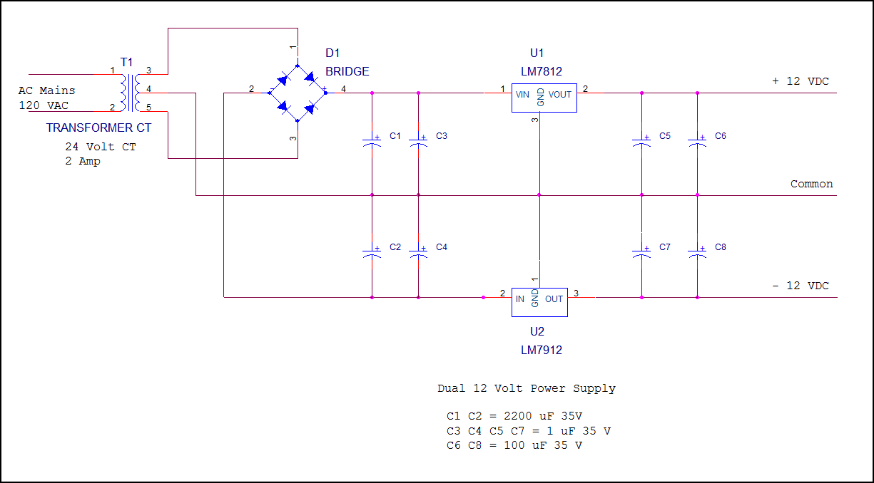

Attached is a rough of the type power supply you need for the op amp circuit. You could use a 1 Amp version (the transformer). I did not look at what the chatter is about with the LEDs but you need a dual +/- power supply for the op amp. I believe what you posted was a single output power supply.
Ron

You need a dual supply for the op amp and so both LEDs will work. When we say dual supply we mean two voltages referenced to common as in -12 0 +12 so it isn't just a matter of negative and positive single supply. That is keeping it simple. Also at $24 the suggested kit was a nice deal and adjustable.
Ron

I thought that the UM741 solved that problem. Problem is that I do not have a common tap comming off the transformer, just 20 volts. Then the directional indicator has a driver power input for only two, a + and a -. Do I just run the two grounds off the 7812 regulator grounds? Also, if I get the $24 PS, won't I still have the problem of having just a - and +? Thanks
OP amps don't have a power ground UNLESS you make the (-) supply pin ground, but you need a dual supply.
The ground of the regulators will be the ground of the circuit, . The (+) and (-) supply from Jameco will have a ground point.

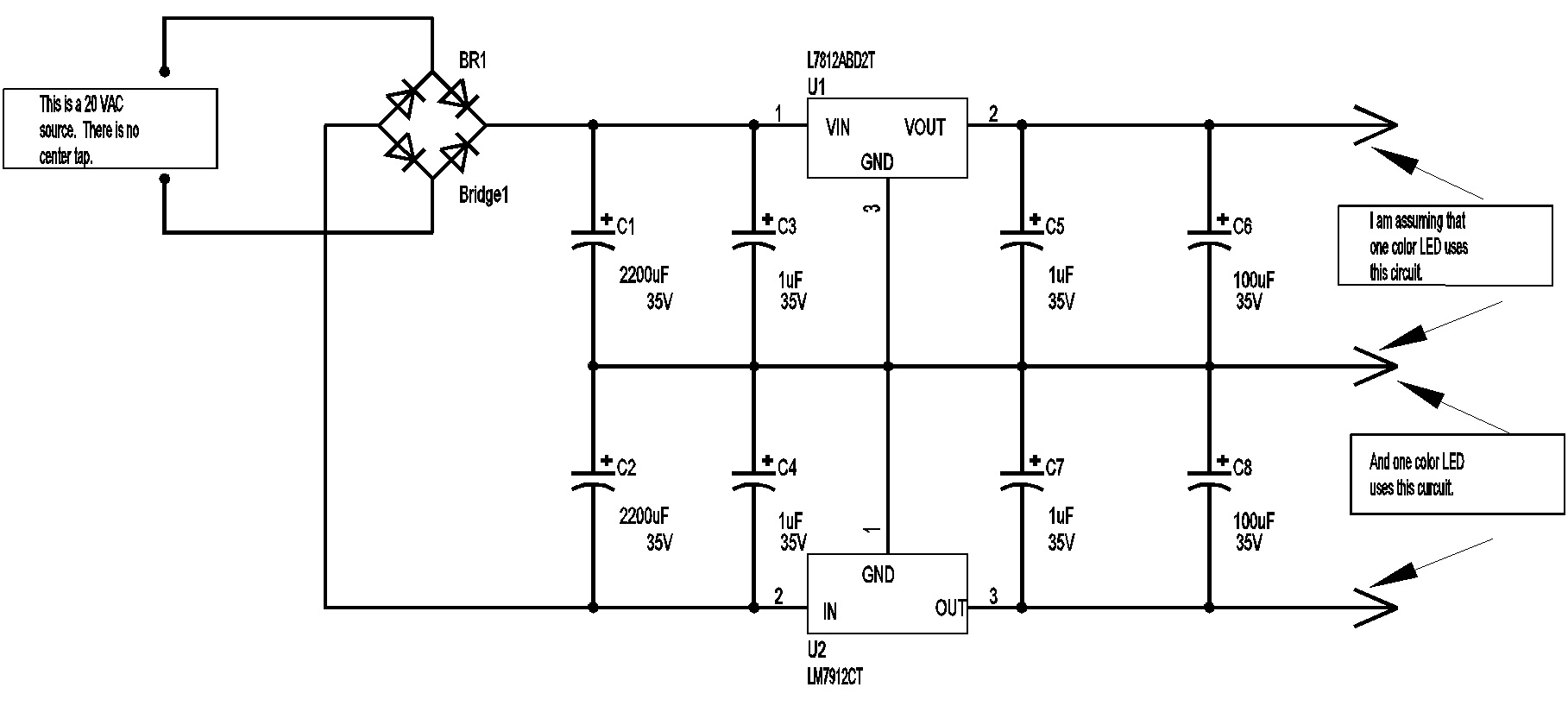

OK Ron, Andy and the rest of the gang, this is my latest design. The 20 VAC from the transformer does not have a center tap, so this design does not have one, so will it work this way? I used the grounds from the regulators the way Ron set them up without the center tap from the transformer.

Sierra: The Bipoler power supply is just to power op amps not so much the LEDs. Andy
Hi Ya

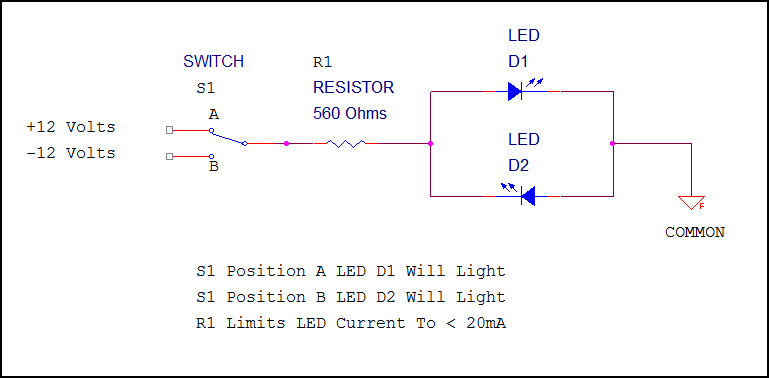

If you go back to my suggested power supply I laid out a dual +/- 12 Volt supply and I used the transformer center tap. I also used a 24 Volt center tapped (12-0-12) transformer. That is important. OK here is a little overview. The regulators need at least 2 volts above their regulating voltage to work. The transformer outputs are 12 volts AC RMS. Each half of the transformer is full wave rectified off the diode bridge. Those first capacitors will charge to a voltage of E PK or the RMS value times 1.414 = 16.9 volts. That allows the regulators to work. Each of the 12 volt outputs (+12V and -12V) based on the transformer I suggested will be capable of about 1 Amp more than enough for many op amps and LEDs.
As to the Op Amps based on input polarity the outputs will swing close to the rail voltages. Close to +12 or -12 based on the input which is the track polarity. Attached is an image showing a rough idea of whet will happen.
Hope that helps.
Ron
