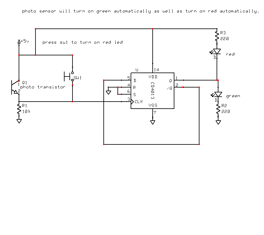

Sounds like you need a train detection circuit plus a S-R (or J-K) flip flop. The site that you named has various detection circuits. The flip flop is set by a signal from the detection circuit and reset by a momentarily closed switch. The red and green leds are connected to the outputs of the flip flop.

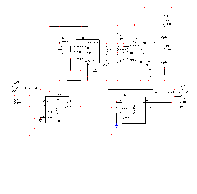

Here is a circuit i was playing with
train passes over section of track, yellow led comes on then two alternating flashing leds come on.
all stays on until train has pasted crossing
has yet to be actually built, just simulated on LT Spice
uses photo transistors

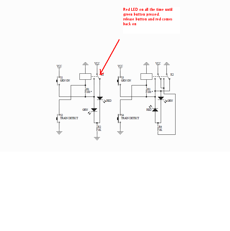

You can use a relay to latch the LED on and to control the LEDs.
Attached pdf shows how you could do it with a SPDT relay for separately driven LEDs or using a DPDT relay for a bicolour LED. Train detect switch can be a reed switch or just a wire to touch an appropriate part of the train as it passes.

Obviously it's up to you. You can do the same thing with a couple of transistors wired as an RS F/F. Or with a couple of AND or NAND gates (and support RC components). As always there's many ways to do garner the same outcome.
Also, I need to use only one LED which has Red and Green - not two as drawn on the schematic - also will Dougy's schematic work on 12v DC ?
Dougys circuit dosn't work as you want
Red stays on all the time except when pressing the N/O pushbutton. Release the button, Red comes back on
In attached schematic the LEDs come on automatically. You need two sensors or one sensor and one monetary push button.
yes the schematic I have posted will work on 12v but resistors will need a higher value.
R = Voltage (12) divided by current (20ma)
BUT the forward voltage of LED needs to be included.

here is a circuit that does it all automatically No relays etc. and yes it is a working project and a pc board is available
