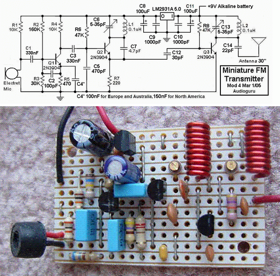

My transmitter has a range of more than 2km across a wide river valley to a very sensitive FM home stereo or very sensitive FM car radio. Its range is about 300m to my Sony Walkman FM radio.
It uses a 9V battery that produces 36 times more power than a 1.5V battery.
Its antenna is 80cm long.
It has an RF amplifier transistor feeding its antenna.
I used it for only about 1 hour because it is illegal.

You haven't described the antenna, so I assume it is a piece of wire coming from the unit, or perhaps a simple telescoping rod antenna. Your desire to double your range to 30 feet is refreshingly modest. Most people want to improve range from 10 feet to 3 miles! I think you can improve things a lot by making your antenna longer or higher or both. You may find that certain lengths are better than others and longer isn't necessarily better, but to find those lengths you may have to experiment, the old cut-and-try method. Others have found that these lengths are often very good (+/- 25% or so): 1.25m or 0.63m.
A guy on another website souped-up my FM transmitter and got much more range out of it. I didn't try it because the range of mine is far enough.
It is mono, not stereo but it sounds great.

You forgot to post the schematic of your FM transmitter for us to recommend a mod that will increase its range.
You also forgot to say if your receiving radio is a cheap one with poor sensitivity.

You have a very cheap FM transmitter and a very cheap receiver. 10 feet (3m) range is pretty good.
