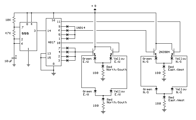

Ok so I am modifying this
https://www.qsl.net/yo5ofh/hobby circuits/circuit pictures/traffic.gif
As it shows only 1 'set' of Red Yellow and Green LEDs for 2 directions, I want to make it 4. I am not sure if adding more LEDs changes any of the resistor values or not and would like some help with that. I have modded it into 2 possible Schematics that I hope are right.
First one
https://i233.photobucket.com/albums/ee268/Allan-2greasy/TrafficLightsMod.jpg?t=1263104616
I just basically duped N/S and E/W but I believe there is a way to do it that will use less parts....

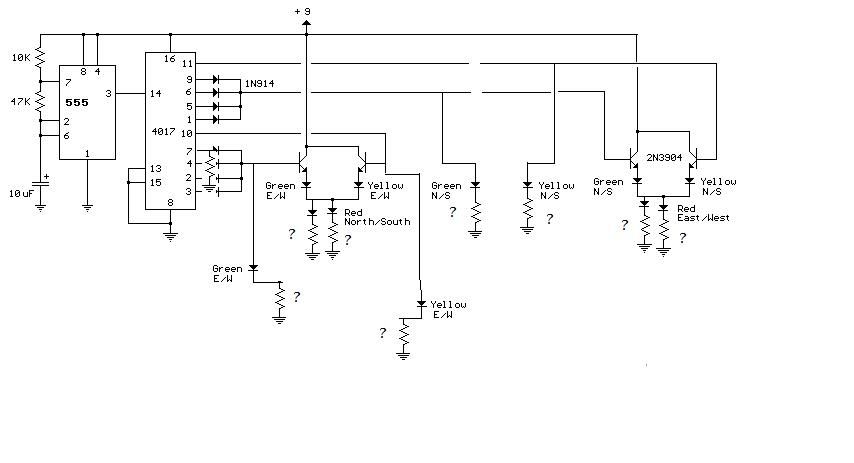

2nd Diagram, if my logic is correct(I am pretty sure, but then again I have no idea...) then this should be a cheaper and more efficient way of doing this.
https://i233.photobucket.com/albums/ee268/Allan-2greasy/TrafficLightsMod2.jpg?t=1263104753
First thing I just noticed is I got a ground sign overlaping the set of diodes, just ignore that I got it uploaded already don't want to reupload.
Anyways with this here I believe I can bypass the extra set of transistors saving me some time and money, am not 100% if this works and I also have no idea what the new resistor values should be. I am thinking the 2 red LEDs will be a problem, should I series them?
One thing why I am having troubles calculating the LED voltage is, I really don't know what voltages comes out of the 4017 or the 555, is it 9Vs all around the diagram? Do I calculate the LED's resistors like I normally would off a 9V circuit then?
have you made this circuit? it looks pretty faulty to me. if i'm right, then the green LED is on for most of the time (ie: during the red or yellow light). when i get to another computer later, then i may be of more help.
I dunno maybe I am seeing it wrong, but in either diagram either of the Greens should only be on for 4 'ticks' right?
And some of the parts don't get stocked till tuesday so I don't have the necessary parts to test it out.

I would try this:
The 2N3094 has a max continuos collector current of 200 mA which will be enough to drive the extra LEDs. You might need to put resistors in between the output pins of the 4017 and the bases of the NPNs. I'm not sure if they are necessary to limit the current output from the 4017 or not.
@vne147: Excellent solution!
Your question: You don't need base resistors. Resistance in the emitter circuit takes care of current limiting.
Ahhh, I understand. Should have figured that out. I tend to err on the side of caution when I'm unsure so I thought I'd mention it. Thanks.
Another question, are the diodes on the output pins of the 4017 really necessary?
I am not sure about the diode question, I just kept them there because they were in the original, the question should be simple to answer of course if you know the answer to a different question, does the 4017 have polarity?(Which I think it doesn't) If not then they would be needed. Because then the power could go back into the 4017 possibly damaging it?
I like the diagram you posted makes a long more sense paralleling each 'set' of leds but at the cost of only 2 NPNs per set and 2 resistors.

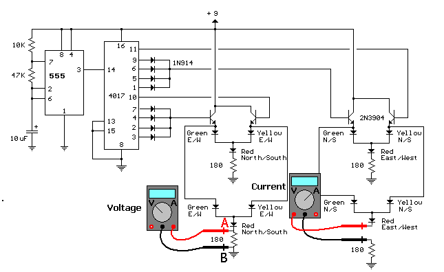

Refer to the attached schematic. You need to measure the voltage between points A and B. You do this by placing the multimeter in parallel with the resistor. Once you select the voltage setting on your multimeter place the positive (red) lead on point A and the negative (black) lead on point B. Now power up the circuit. The voltage you measure will change depending on whether the green or yellow LED is lit. Record both voltages you see and calculate the difference. The difference is what you must account for with your extra resistor.
You're not done yet. You still need to measure the current through the resistor. You'll have to measure the current differently than you did the voltage. First select the current measurement on your multimeter. It will most likely be marked "mA" or "A". You'll also have to change where the positive (red) lead plugs into your multimeter as most multimeters have one jack for voltage measurement and another for current.
Once your multimeter is reconfigured, hook it up like it shows in the schematic. You'll need to measure the current by placing the multimeter in series with the resistor. You should still do this with the resistor you measured the voltage at, I just showed it with a different resistor in the schematic for clarity.
Like with the voltage measurement, the current measurement will change depending on whether the green LED or yellow LED is lit. Record the current that you measure when the green LED is lit.
Once you measure the current, calculate the necessary resistor value using Ohms law.
V = IR or R = V/I since you want to find R. Pay attention to the units and remember that 1 mA = .001 A. The units you should use when you calculate the reststance is Volts and Amps.
