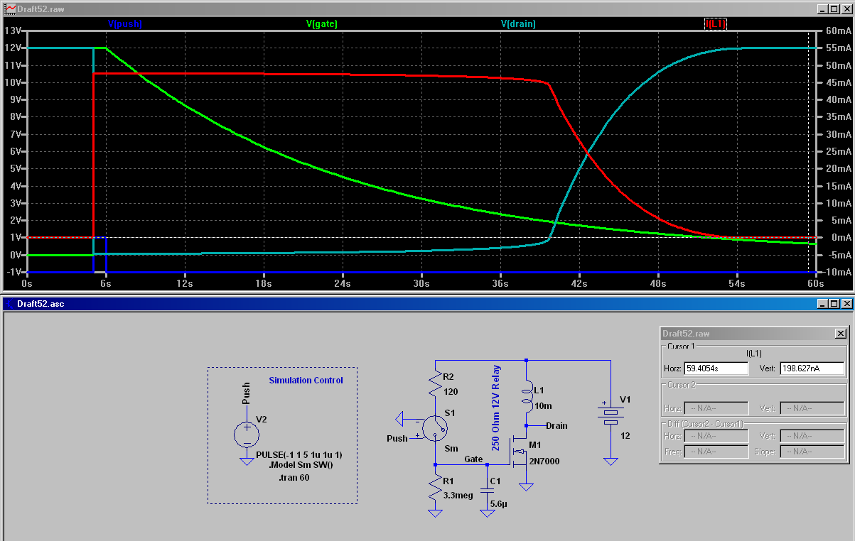

Another way to do it. Zero current draw after the timing event. R2 limits charging current. Works with any 12V relay. NFet not critical; almost anything you have in your junk box will work...

I will certainly try Mike's circuit - it looks very simple - I just didn't have anything anywhere near a 3.3meg resistor (I've ordered some), or the exact 5.6uF capacitor (had close, but not identical - again, some are on the way).
I'm also interested in the simulation Mike did - is this LTSpice? I need to get into simulation, but there's so many available I don't know where to invest my time learning - is this a good one to start with? Would it be capable of simulating something complex like your 555 circuit?
Mike's 5.6uF cap is probably just a number picked for the simulation. That's not a standard value. That particular RC combination works in simulation, but may not work in the real world. Electrolytic capacitors have a wide tolerance range that can vary as much +/- 20% from the labeled value. You can parallel capacitors and string resistors in series to get what you need for a particular time.

5.6uF is a standard value. The time delay is about 2.5RC = 2.8 * 3.3e6*5.6e-6 = 45sec. You can use 1meg and 15uF. Note that a snubber diode is not needed because of the slow turn off of the FET. A second push button to discharge the timing capacitor would shutoff the relay early.

Was it LTSpice that you used for the simulation? Is this the best software for me to learn as a beginner?
