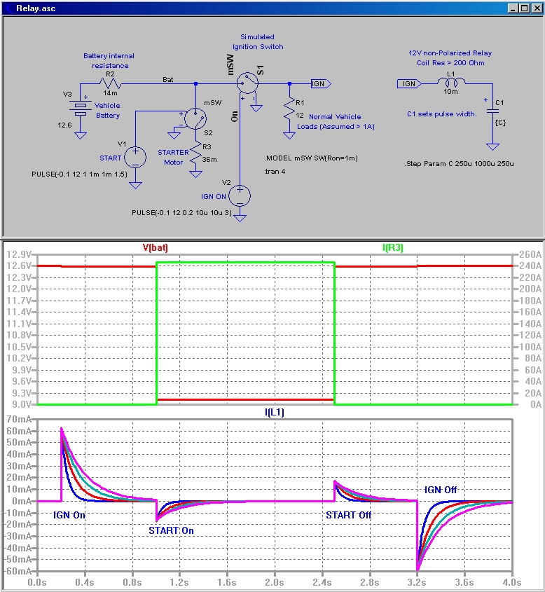

Are there two different "buttons" to push momentarily or only one, which toggles (opens/closes) the screen?

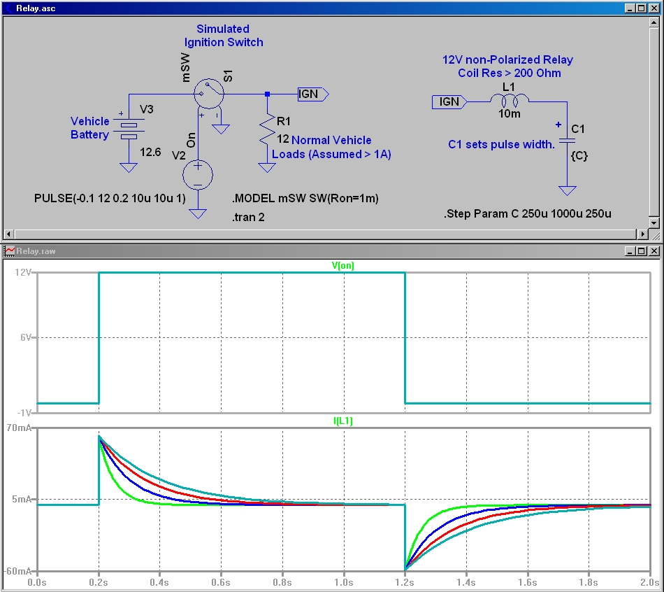

Assuming only one button, the attached simulation might work for you. I show only the relay coil. I assume you will wire the normally open contacts to your push button.
I assumed some things about your car, including that the ignition switch has at least 1A flowing through it when it is on.
The design is based on finding a 12V relay that has a coil resistance ≥ 200Ω. It should also be non-polarized. There are some relays out there that biased with a permanent magnet, so they pull-in with current flowing only one way. For this circuit to work, the relay must pull-in with the current flowing in either direction.
The timing capacitor is a large polarized electrolytic. I ran the sim with four different values of the cap: 250uF, 500uF, 750uF and 1000uF. Note the duration that the current flows. The relay will stay pulled-in until the current drops to about 1/3 of its initial value.

yes there is only one momentary push button on the screen. so your schematic should work. :) . im having problems understanding your circuit though lol. :-S um... any chance of quick re-draw any easier way? lol. sorry mate. x
Everything on the left side of the circuit diagram is already in your car. The two components on the right side are all you have to add, just a relay, and a capacitor.
Read the previous post again, and notice that just not any 12V relay will work. You will have to go looking for one that has a higher coil resistance compared to "automotive" relays such as made by Bosch.
The capacitor value controls the duration of how long the relay is pulled in, the bigger, the longer...
Basically, the current through the relay pulls it in as the capacitor charges when you turn on the ignition switch. When you turn the switch off, the relay discharges the capacitor backwards into the car. The current pulse/duration through the relay coil is similar in both directions, except for the direction.
Don't depend on having +12V while starting your car. The battery output voltage can drop by as much as half while the starter is engaged.
True... but before the starter turns the car turns on the accessory... so at the time of this relay powering the voltage SHOULD be 12v. then when the car turns over all the relay work would have been done. x
So, what happend when the relay de-energized while the starter motor is engaged, then re-energized after the car is started?
Maybe you'll get lucky, and the cap will be half-charged while starting, then the relay won't engage when DCV returns to 12V.
Hmm... when the cars actually running the alternator makes the voltage about 14v... so would there be a way to put in a threshold of 13v until the relay is charged. would that solve the issue? x
I love the scheme for it's simplicity, but there are variables. For example, on trun-off, will the "other" loads be enough to discarage the cap rapidly enough to engage the relay? IMHO, a workable solution will be more complex.

I added the starter motor and the drop in battery voltage during starting. I assumed that during starting, the battery voltage drops to 9V as modeled by the battery series resistance and the starting current of about 250A.
I think that the current pulses caused by the starter on and starter off events are not large enough to pull in the relay.
As for the timing capacitor discharging though the car's load when the IGN key is turned off, I already considered that. Show me a car where the current through the Ign switch is not at least 1A.

ok. so the original circuit should work :) . now its just finding a relay thats suitable. also i cant see the relay is activated when the ignition 12v feed is 0v though - i know my skills arent good. but fancy just explaining briefly how? :eek: . if a relay states nothing about the polarization - can i assume that its a non-polarized, or is standard polarized? and if i found a relay with a higher resistance would the capacitor value need changing? cos i couldnt find one with a 200Ohm coil resistance and 12Vdc coil voltage. x
Look at the current through the relay plot. Note that when the IGN switch is turned off, the capacitor was previously charged to 12V, and then it discharges through the relay into the 12 Ohm load resistor, which is all the stuff in the car that the IGN switch normally powers. We are banking on the fact that the loads add up to at least an Amp.
You can go as high as you like with the relay coil resistance; the higher the resistance, the smaller C1 can be.
You can go lower, but C1 becomes very big.
ok thats starting to make sense. and just one more question to help me understand... how does the capacitor or coil resistance stop the relay from being constantly powered when the ignition 12v is on? x
