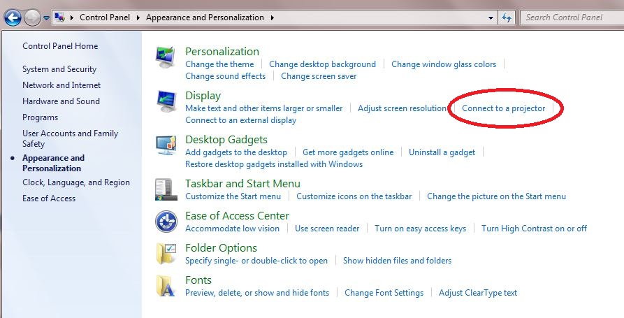

On some PCs you can configure the PC video adapter to provide a composite (RCA) video signal at the VGA port (such as on my HP Pavillion g7). Thus, the cable you hacked might work.
For that we need to know the particulars of the computer (especially the VGA video adapter) you wish to connect to the Commodore monitor.
VGAs often can be configured so that they can be attched to screen projectors (like in a classroom), almost all of which take a composite input.

I don't see any options like that in the control panel. The computer I use for programming is 6-8 years old. I had it put together by a friend of used parts so WHO KNOWS. It works great for what I use it for. It's not on the web. Thanks for your help.
