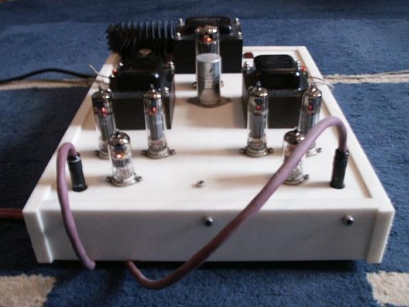

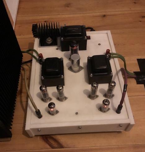

Here an image of the newly built amplifier.
And as it stands now.

What is your amplifier above built on?, it doesn't look to be a metal chassis?. Must admit, the only valve amp I ever built (back in the 60's) was built on a piece of hardboard from the tip, and mounted in an old suitcase (also from the tip), with a speaker and grill also mounted in the case. Pretty well everything came from the tip, including most of the components - with the exception of the 6BW6 output valve, and mains transformer, which I was given (as those weren't commonly available at the tip).
I still have the old suitcase, complete with hole where the speaker went - I've no idea what happened to the amplifier out of it?.
The material is Corian, widely used as countertops, is from Dupont.
I suspect it's screening properties aren't too great? :D
Which is the reason for using a metal chassis, particularly for hum reduction.

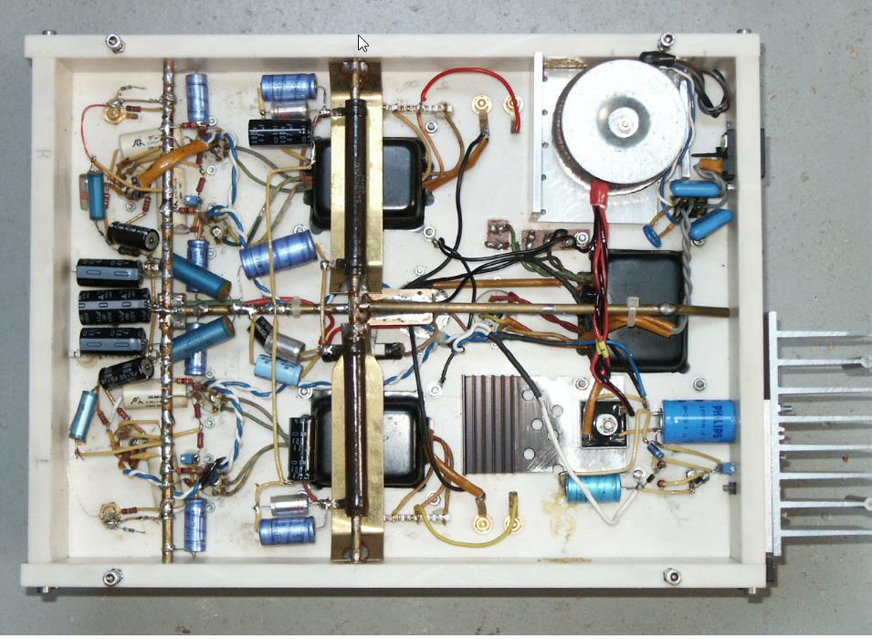

Here is a picture of the bottom of this stereo tube amplifier.
Looks like rather a nightmare to wire. :eek:

Here is a picture of the bottom of this stereo tube amplifier.View attachment 131616
Interesting busbar type construction.
I don't understand the fascination with antique tubes and vinyl, but to each his own
Some people like old cars
Some people like old houses
Some people like <insert item here>
As you say, each to their own.
I was thinking that myself.
All in all it is a strange form of construction, I would not choose it myself,
but it is very nicely done, looks good.

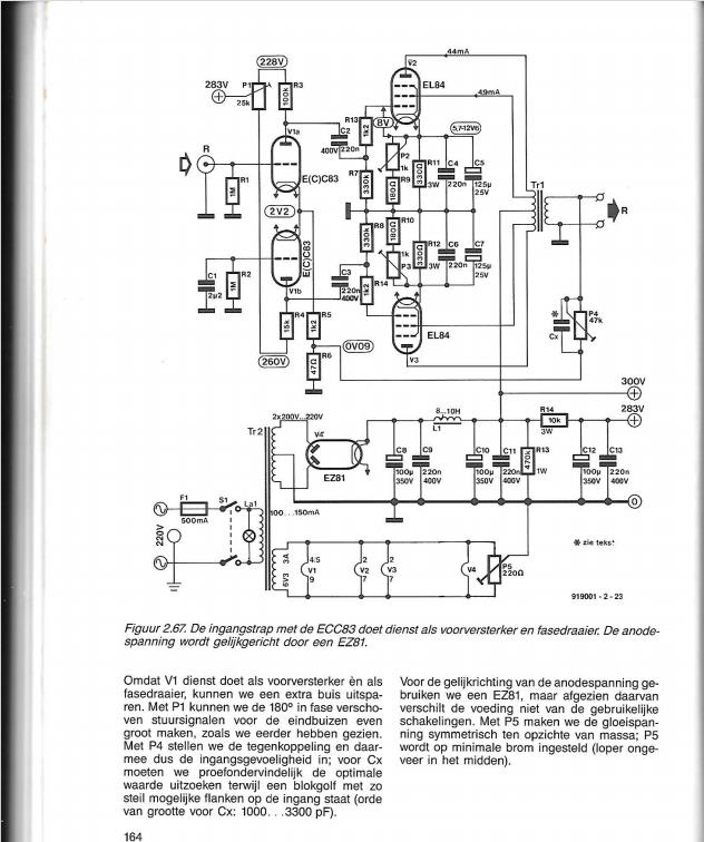

I went to look for what is present in my house in terms of diagrams of tube amplifiers.
I came across a diagram in a book by R. zur Linde that I really like, what do you think?
As an extra I would stabilize the filament voltage with an Lm338K TO3 housing.
Greeting,
Pim
Looks like a standard circuit, that should work for you.
Of course you will need a rectifier bridge and capacitor to generate the DC voltage required.
The total required filament current will determine the size heatsink you need for the regulator.
6.3Vac will generate about 7.8Vdc with a Schottky diode bridge rectifier, so you will likely need a low-dropout regulator (which the LM338 is not) to get the regulated 6.3Vdc you need.
Go find a transformer with 10 volts extra, then the LM338 TO220 housing can be used, if I don't find such a transformer, then an option is to Amplimo to have a transformer wound to specification.
