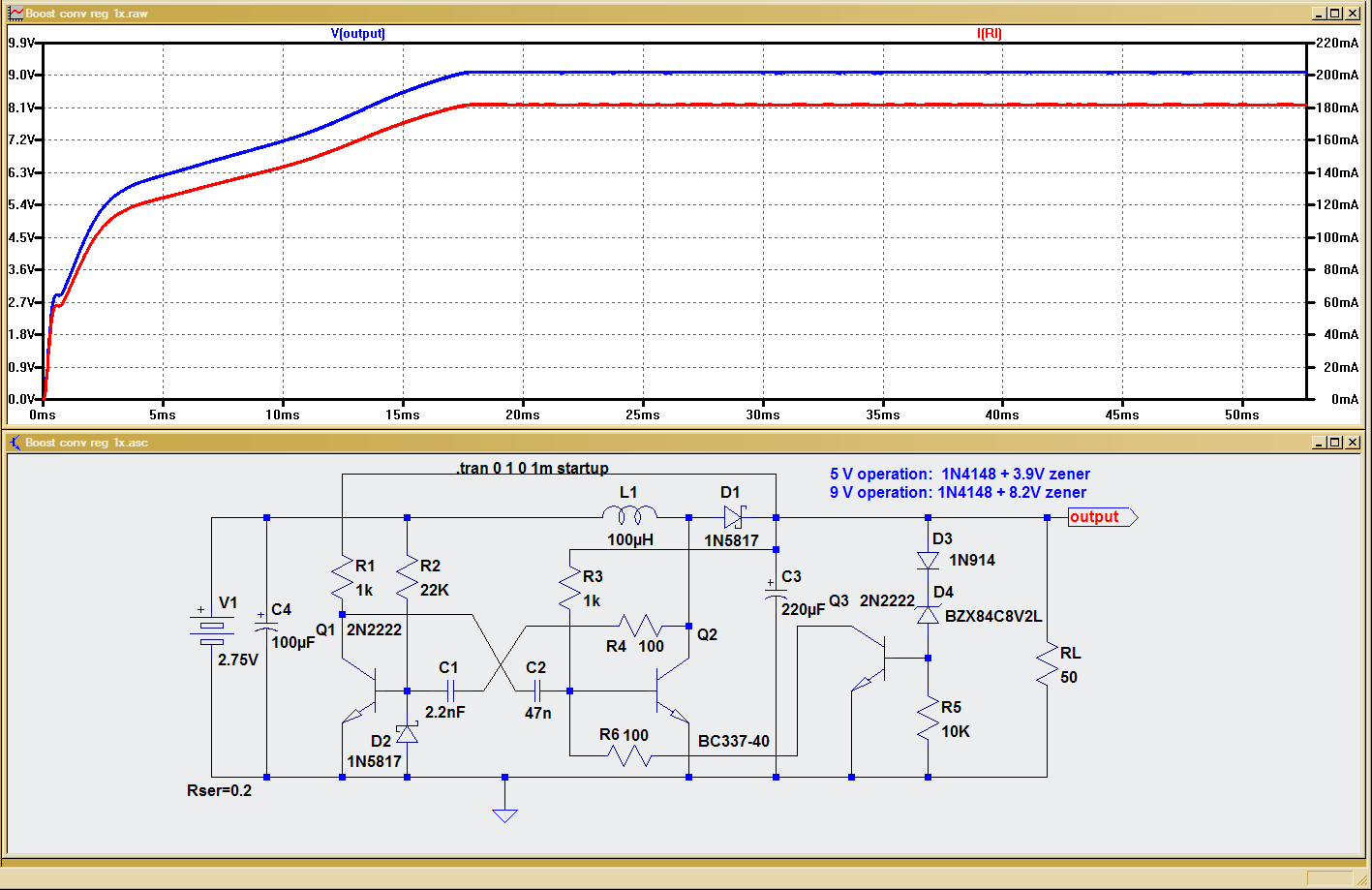

I went back and played with the "power multivibrator" simulation, tweaked it a bit, and then breadboarded a version. (LTspice file attached below.) Here's the schematic:
Here are the results I got from this:
With a 100Ω load:
Vo: 9.1V
Io: 91 mA
It won't give enough voltage as shown, with a 50Ω load, which is disappointing. Can't even make it at 75Ω. (The LTspice simulation works great at even heavier loads; unfortunately, the real-world model doesn't work quite as well.)
The power multivibrator is not a good choice for a FET due to the slow ramping up of the Vgs voltage. The best fix might be to use 2 NPN for the multi to give good square waveform, then use that waveform to drive the FET. Total solution; 3 NPN, 1 FET.
Butbutbut ... that's pretty much exactly what I showed above, no? (Minus the last transistor for regulation, of course).
I'm still not convinced that a MOSFET driver is not the way to go, but that's at least partly because I just want to finally work with one of those devices. I still could really use information on selecting a specific MOSFET.

The gate of your Mosfet has a high capacitance. It is slowly charged by the 1k collector resistor R4 plus the 220 ohm gate series resistor R5. The slow charging causes the Mosfet to slowly ramp instead of quickly switch.
hi cz,
This is a bootstrap option, needs a little more work.
Change the 8V2Z back to your model
  • Boost conv reg 1x.asc
