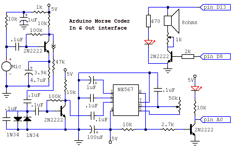

Morse encoder/decoder - my first project

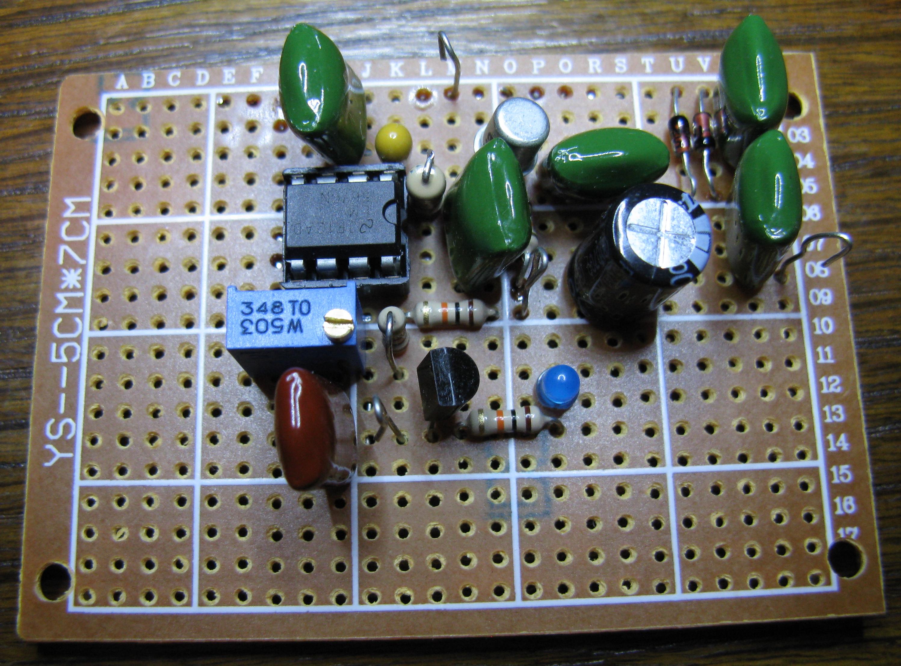

Breadboard time...once the level shifters arrive.
Still working on the 567 tone decoder. Fine tuning some capacitor values and types. Would using back to back germanium diodes at the input help or hinder, etc.

Not enough variable memory to include the LCD backpack routines. :-(
up-dated input interface using a tone decoder to improve 'off the air' detection.
Not finished. Suggestions very welcome.
Edit: Maybe finished :)
