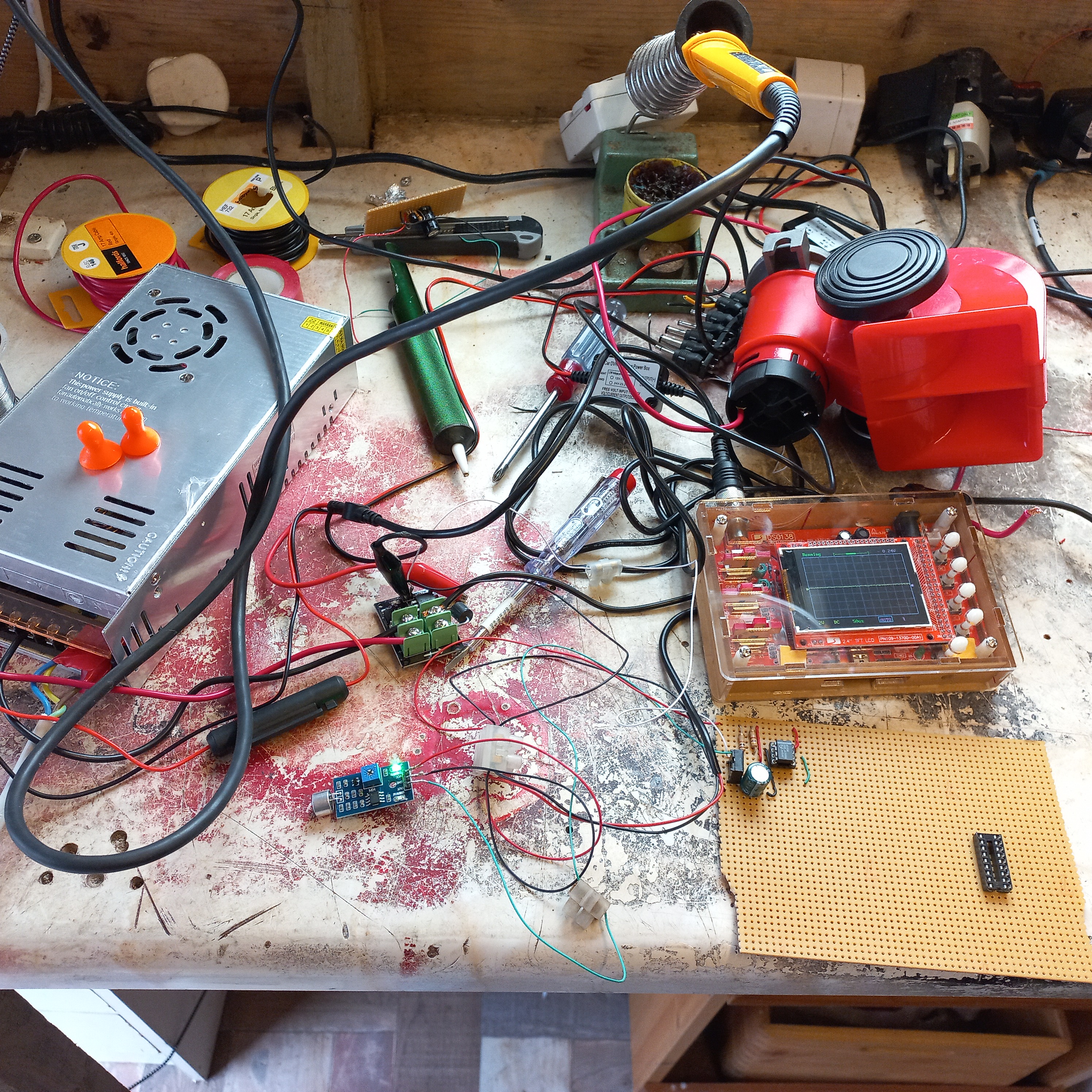

Opto isolated. I cannot figure out how I will trigger it. Instructions are vague to say the least.
wendeekun Low Voltage MOSFET Switch Module 12V 24V 36V Field Effect Transistor Module Mosfet Kit Uses Optical Isolation https://amzn.eu/d/7X0lZdg
  • So, here's what I am trying to do, only now do I realise the output of this sound module needs to be inverted to go low when sound happens. Sound Detection Sensor Module Suitable for Arduino and Microcontrollers https://amzn.eu/d/iM3DgYp.
  • This goes into pin 2 of a delay off 555 monostable. http://build-electronic-circuits.com/555-timer
  • I was able to get pin3 of 555 +ve, on trigger of +ve into pin2 from the sound board when sound occurred, don't ask me how. Maybe it is the low pulse afte the sound board realises there is no more sound. BUT, when pin 3 of the 555 was connected to the + in of that MOSFET board, and -in of the MOSFET board was connected to ground, the MOSFET stayed energised and wouldn't turn off. I am missing the small cap at pin5 of the 555 CCT though.
  • Do I connect +in of that MOSFET board to 5V and invert pin3 of the 555 output and connect that to the -in of that MOSFET board? If so, do I need a R from +5V to +in to restrict current once inverted 555 pin 3 is active?
  • Thank you all.

I am so thick, no really I am. I did not mention that the MOSFET output is connected up to a very loud horn. It's the horn that is keeping the CCT activated since the sound board is activated by...... You guessed it sound.... From the horn, and the 555 keeps triggering even though it has already triggered.
Now I need something to stop, delay and then allow the next trigger on a +ve from the sound board into the 555 CCT, for longer than the delay off CCT to allow the horn to finish it's blowing and the CCT to calm down again ready for the next sound trigger.

So I programmed the pic for output and it works. 8 pin IC, no caps, no resistors, internal osc. Wired straight to input of MOSFET board.
Now to program interrupt based input from the sound board, let the pic 16F628 count the numbers of times the input goes low every couple secs and after a certain count, triggers the MOSFET and blows the horn.
If anyone knows how I can program that esp board, like really knows how I pick it from the list of DEV boards in any ide, I would be grateful.
