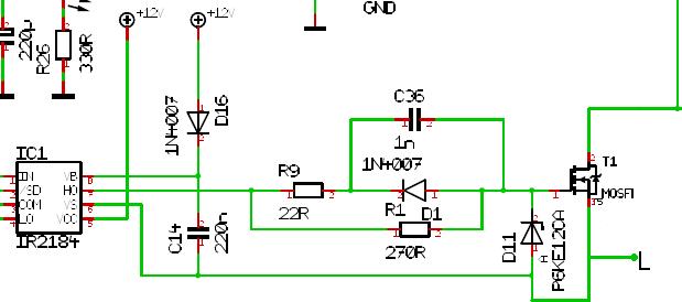

but have sawn a HO to Gate schema wich looks like the pic.
can someone explain wy it is this way?
L is the motor terminal.
D16 & C14 are the bootstrap.
Also i know the current limiting resistor 22R but wy that diode?
wy D11? Wy D1? wy C36?
its from a servo controller.
Tks
