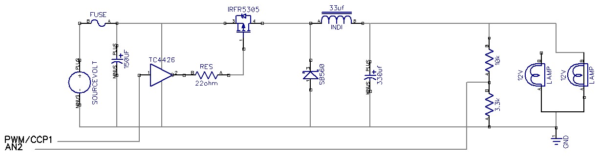

Mosfet Gate Capacitor?
Have noticed when putting a 20pf scope probe on the gate to a sfp9540 mosfet, that some oscillation is damped out when full turn on is reached. There is 22ohm gate resistor, and is being driven by an inverting TC4426 mosfet driver. Is it worth putting a 20pf cap on the gate to clean up the waveform? Would the other side of the cap go to gnd?
Follow up question, there is a bit of oscillation encountered at turn off too. Any reason to go after that, and how? A 47k pulldown resistor is used on the MCP4426 inverting input.
Just leave the scope probe attached :)
Just kidding. It would be helpful if you posted a schematic, so we can see what you're working on.
It is a continuing experiment with a solar battery charge controller. Playing with a buck converter configuration at the moment. Please note the irfr5305 has been replaced with the sfp9540, as the irfr5305 seemed a little too touchy for my bumbling around.
P.S. Schematic doesn't show pull down resistor on TC4426 input, but its there.
I'm wondering if you've formed a closed-loop margnially stable oscillator between your MOSFET and the driver power connection. If so, then bypassing capacitors and careful layout might fix the problem.
The loop is not closed yet, just straight pwm at whatever volts, amps the circuit allows. The lamp load is 500-600ma in full sun. Its a really crummy, cloudy day out, and the circuit is not even stable enough to test under load yet.
Was hoping to work on the feedback loop today.
Sorry, talking about the wrong oscillating loop. Will stick on a 20pf bypass to gate and take another look at the waveform. The driver and mosfet are on vero board, could that be the problem?
My guess it's caused by coupling from your transistor back to it's driver. When the transistor switches, it draws current through the resistance and inductance of the wires and voltage source resistence, which couples back to the driver. Use seperate connections for your switch and driver back to your voltage source. Try larger guage wire, and bypass caps. You many also increase the value of your 150UF smoothing cap. Your voltage source resistance might bite you, and require a redesign.
But if using a small cap on the gate works, then go with it.

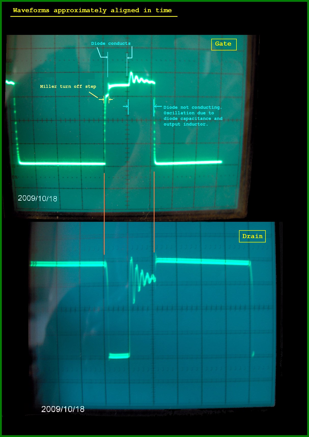

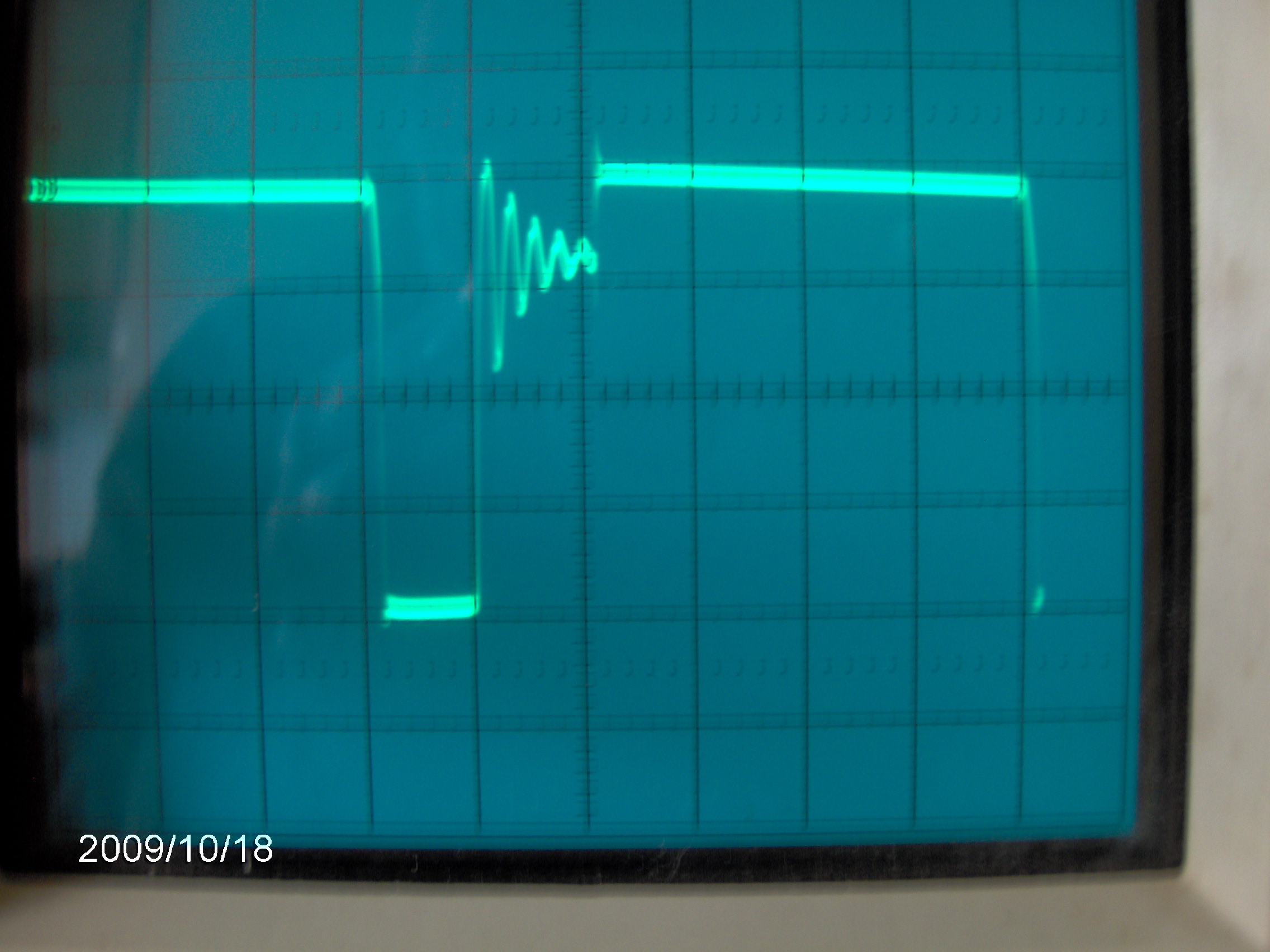

Happy to show my ignorance here, so included the waveform pics. First picture is taken right at the mosfet gate. Adding the 20pf cap did nothing really. Second pic is at the pfet drain. I was confused when looking at the output side of the pfet drain, and sort of transposed that to the gate. It may actually have nothing to do with the gate, but more of a function of the circuit?
Just learning about buck converter, so if someone could comment on cause and effects of the two waveforms, would be much appreciated.
Thanks to everyone for the help thus far.
Trace Notes: Vert 5V/div Horiz 5us/div

Oh ok, that oscillation isnt always a problem. As long as the ringing peak doesnt
go too high. That's caused mostly by the resonance between the diode capacitance
and the output inductance.
Here are the two waveforms annotated a bit...you might have to zoom in to
see the annotations though.
I'm happy that you showed the waveforms. They don't look like scope artifacts, so that's cleared up.
I haven't done the calculation, but you should confirm that 33µH is correct. To me it seems pretty small for a 30 kHz switcher. It also could be saturating. You should also confirm that it's rated for the current you're passing through it. Do you have a part number or markings?
Keep in mind that solar panel is a current source clamped by forward biased diodes.
You can make it look like a short period voltage source with a big enough cap. Don't know what current you are pulling during coil charge but 150 uF may not be large enough.
Does ringing go away if powered from a real voltage source power supply?

It could still be artifact from your scope's gournd wire, depending on how long that wire is. Either way, it doesn't look like a big deal to me.
That ringing is the diodes capacitance in series with the 33uH inductor.
This is very very typical for a buck, and i've seen it many times in the past.
If you add more capacitance (a little more) across the diode, you see the
frequency of the ringing go lower, and if you calculate the resonate frequency
lo and behold it's the same as the ringing :)
It happens because the diode stops conducting, and once it stops conducting
it's like an open circuit and all that is left is the capacitance in series with the
inductor. The mosfets capacitance may contribute a little too during that time.
It's not too bad as long as it doesnt go too high and thus exceed some components
voltage rating.

Yes there is a blocking diode on the input after the fuse and on/off switch. I need to update the schematic to show what all is involved.
