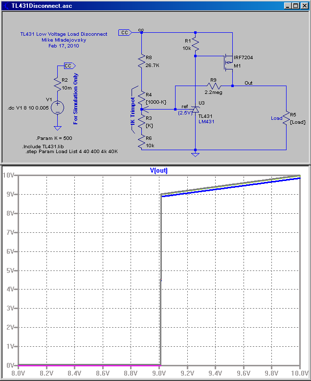

Yeah, using the LM431. It behaves differently depending on the load i use. With a simple led on the output i was getting pretty close to 9V switch on. when i used a larger load in the order of amps it alters the switch on.
I re-simed the circuit with different load resistances, ranging from 4Ω to 40KΩ, and I see no sensitivity to load resistance. Are you sure you have it hooked up as shown here?

i did not use the IRF7204, and i changed the 2.2M feedback resistor to a much lower one because i wasnt getting the snap i required. I think i changed it to something like 50k. The switch off voltage is very snappy, but the switch on voltage still seems a little slow.
What is the threshold voltage (Vt) of the PFet you substituted>

Hi All,
Is there a formula to calculate the hysterisis values?
What i find is that when i have a load connected to my circuit as soon as the threshold value is reached the mosfet turns off but not fully. When the load is disconnected the voltage at the gate actually increases thereby turning the mosfet back on. I have not put a scope on this yet but i would guess that is probably oscillating.
The circuit is that which mike has posted in previous threads (TL431) driving a P mosfet as a high side load switch. The circuit is being powered from a cap (acting as a backup battery). Once the voltage on the cap drops to a determined level the load should be disconnected.
What i would like to do is be able to define a turn on voltage and a turn off voltage. However i have to give the off voltage sufficient hysterisis to prevent it turning back on which is why i would like to be able to calculate it. Due to the amount of current the load pulls there are losses to take into account which alterts the threshold.
