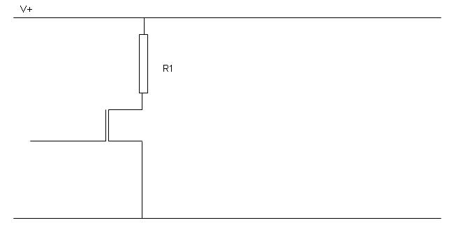

As far as i understand, a voltage applied to the base of a mosfet translates into a flow of current from the drain to source of the mosfet - provided the voltage is higher than the threshold voltage.
Can someone confirm that my understanding is correct and can someone confirm that the current (from drain to source) is independent of the load. Ive attached a rough drawing with R1 being the load.
Yes.
From the graph in the link, in the saturation region the device acts like a voltage-controlled Current Source [whereas a bipolar junction transistor, and a transformer, and possibly a relay, act like current-controlled Current Sources].

So from your response and my understanding of the mosfet operation, changing the value of the POT on the drain has no impact on the current through it and into the base of the transistor (which in turn controls the current through the fans)
Then why does this circuit work so well? As i change the POT the current through the fans moves from 75ma to 15ma.

Just think of your mosfet as a switch. Looking at your circuit the mosfet will be fully saturated therefore its switched hard on. Your current path is then determined via your resistor network. Changing the value of the pot will alter the series current through that path.
