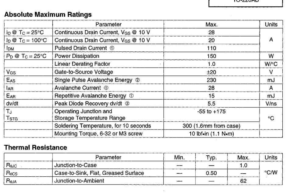

ok first question after reading up. I picked a random part that i have for no particular reason and i am looking at the datasheet as all my questions are datasheet related, the part is IRF540N the datasheet is this one
now according to the sheet it has a VDSS of 100V, so i take that to mean Voltage from DRAIN to SOURCE? or the max voltage you are meant to put through it.
then we have this table
and it shows a VGS +-20V, now my question for this
is the 20V-+ the max gate voltage allowed or the max difference of gate voltage depending on what the voltage is between Drain and SOURCE? for example does it mean that if i have a VDSS of 100V i have to have a gate voltage no lower than 80V?
i am not sure exactly what it means, my feeling is its the max GATE voltage
Now according to the sheet it has a VDSS of 100V, so i take that to mean Voltage from DRAIN to SOURCE? or the max voltage you are meant to put through it.
That is the drain to source voltage that will cause some of them to suddenly conduct current when they shouldn't and get very hot. So do not allow more than 100V in your circuit (it will be safer if you do not allow more than 80V).
It is the maximum allowed gate to source voltage. Its on-resistance is spec'd at a gate-source voltage of 10V so limit the voltage to 10V to 15V.
Maximum VDSS is completely separate from maximum VGS. For this N-channel Mosfet they are usually both a positive voltage.

Your post 8 and the reply in 9 was about 'Absolute Maximum Ratings'. These AMR values are NOT to be exceeded without the danger of destroying the device.
Your post 1 was about using a mosfet as a switch, and the AMR are only half the story to help you to select a suitable device. There are many threads here, where the way to cause a transistor to switch and carry a certain current, are discussed. A bipolar transistor needs a certain level of base current to support a level of collector current. These are 'current' devices. The forward gain characteristic is defined as 'beta' which is Ic/Ib, and is dimensionless.
With a fet, the level of drain current is supported by a certain level of gate to source voltage, and the forward characteristic is defined by Id/Vg. This is a 'conductance' and is has the dimensions of mA/volt or milli Siemens(mS) or for big FET's, in Siemens(S).
So, when you use a fet as a switch, it needs to have an adequate Vgs, and not necessarily the maximum the device can withstand. So you need to ask the question; 'what is my drain current and what is the corresponding drive voltage'. When using these things in high speed circuits, you need to consider the rate of change of charge removal from the gate. From your classes in physics, you will remember that current is the rate of change of charge, so this also is a consideration in device selection, because I= C x de/dt. C will be the gate charge.
