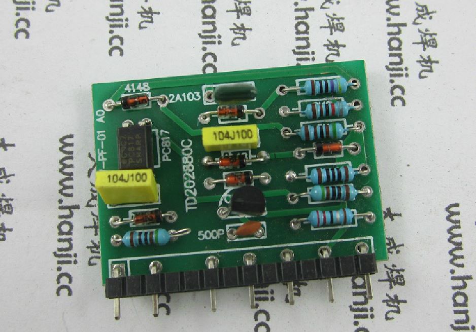

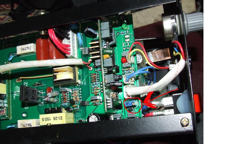

So today i have to deal with a card that belongs to a ARC welder , this card contains a smaall card .
After analysing the suspected areas responsible for the unit's startup , i have discovered some bad components , but i have trouble with a MOSFET (IRFPE40) , i have removed it put in my test breadboard , and without even triggering it i get drain to source connection as soon as i power on the device .
Is it due to static electricity or maybe a bad MOS ?
Also i found (on the small card ) a probably bad npn transistor (Kec MPS 8050D) giving junctions between collector and emmiter while performing diode test mode, can i replace it with a BC337 ??

THanks mab , i have done a test circuit , and things looks good , what about the Kec mps 8050D transistor , do you think bc337 is a good equivalent for it , i am bad at reading technical specs thats why i ask .
Its actually 8050 not 80580 :
Here is the ratings for the two transistors .
BC337 : Ic = 0.8 A , Ib = 50 mA, Vce =45v , Vbc=50v , Veb = 5v .
MPS 8050 : Ic = 1.5 A , Ib = 80 mA , Vce = 25v , Vbc =40v , Veb = 6v .

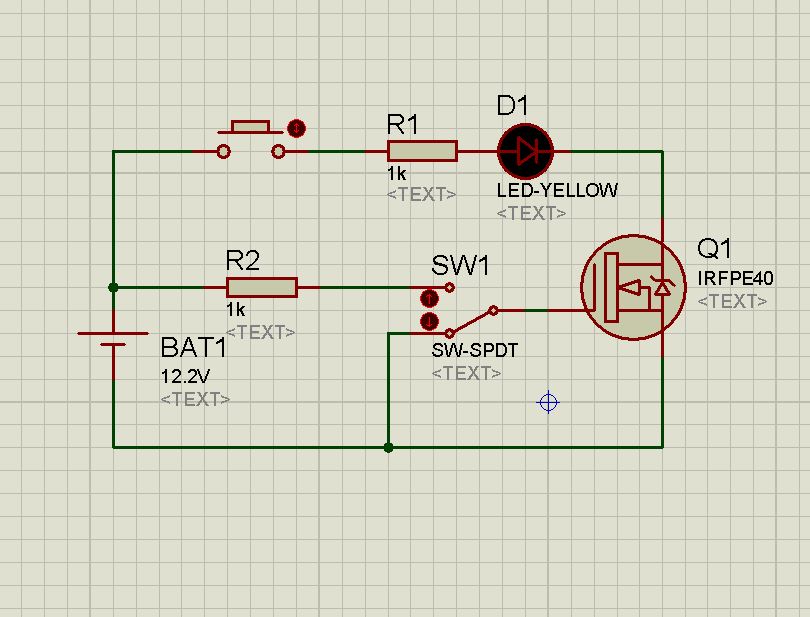

This is the circuit i have made :
  • IRPE40.pdf
Your circuit has gate to source voltage on the mosfet ALL THE TIME so of course the Mosfet is turned on all the time.
Your switch simply turns the LED on and off.
a gate to source resistance is always necessary at the very least for testing a MOSFET. Then to make sure it can turn on ok, energize the gate separately.

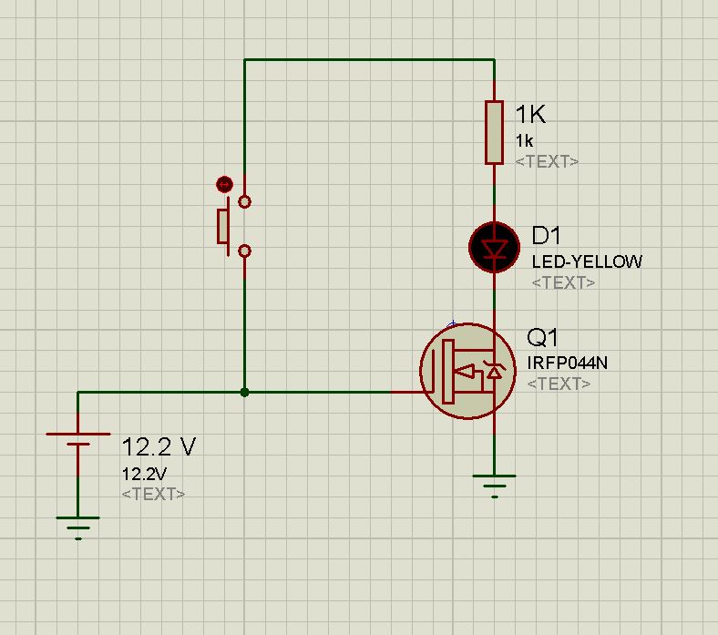

Actually i was switching manually the gate .
THis is the actual test circuit i made ..
Since you were manually switching the gate then why did you post a completely different circuit before?
Your new schematic shows that the switch can connect the gate to the source then the Mosfet MUST turn off.
Sorry for that , was a bit confused .
The mosfet turns off when i connect the gate to ground, and turns on when i connect it to +vcc , this how i checked it , and it actually acting the way it shoud , so everything's good for now .

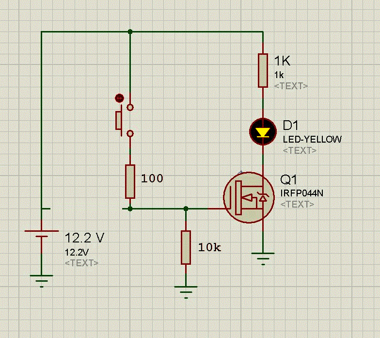

The attached circuit is a better circuit for basic testing, although for that MOSFET you have there it may be better to check it with a little more drain current...that's up to you though.
Hello,
Thanks MrAl , but why did you put a 10k resistor on the groud path ???
That's the resistor to ground that we've all been talking about. You need that to turn the MOSFET off, and keep it off when the button is not pressed.
