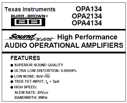

There are many excellent audio opamps such as the OPA2134 dual that has distortion of only 0.00008% and very low noise. Audiophools think its distortion is too high! You might be able to hear 0.1% distortion on music if you have good hearing.
The last time I played my turntable was about 20 years ago and its high gain preamp uses a Japanese audio IC that sounds great.
Your preamp has a gain of 7.7 times so if its output of 7.7V feeds a power amp with a gain of 20 then the output power into an 8 ohm speaker is 3kW! If you use a piece of wire as a preamp then it has no distortion and the 1V output of a CD player into a power amp with a gain of 20 produces a reasonable 50W into 8 ohms.
Why does your preamp have such a high supply voltage?
