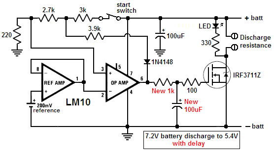

I have a similar timing problem with a circuit I designed on another electronics chat site.
It's a Ni-Cad battery discharger circuit that is supposed to shutoff the discharge when the battery's voltage drops to a certain voltage. I used an "all-in-one" LM10 voltage reference/rail-to-rail opamp and a Mosfet for it.
It detects the battery threshold voltage then the opamp begins to turn-off the Mosfet. It has plenty of hysteresis for fast switching and so it doesn't start discharging again when the battery's voltage rises without a load. It gets stuck with the Mosfet half-turned-on and smoking!
I'm adding a delay beween the LM10 and the Mosfet so the LM10 can finish switching its output before the Mosfet turns-off the load.
