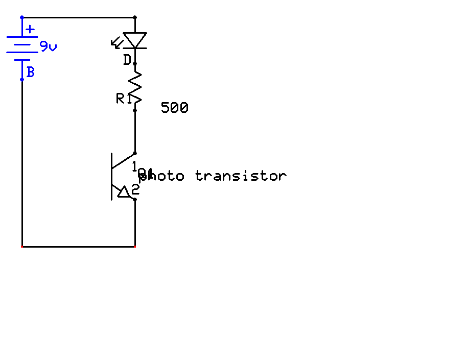

If you bought the phototransistor, try connecting your ohm meter across the part and if you have the polarity right it will show some resistance. the resistance will go down in the absence of light (waving hand over sensor) thus turning the phototransistor off.
this is what you want. An on off on sequence as this will clock the flip flop.
hopfully you have an ohmmeter?
if not try connecting an LED/ resistor in series with the phototransistor and a battery.
the LED should light when you have light on the photo transistor.
if it dosn't then you may have something wired wrong.

you have a flip flop in the circuit
true in a sense
lights all go off at night the circuit is waiting for the light to come back on
when it does the light will come on
wave your hand over the sensor and the light should shut off
wave it again and light should come on
the light/dark/light sequence produces a clocking (like a push-button switch on/off/on)
