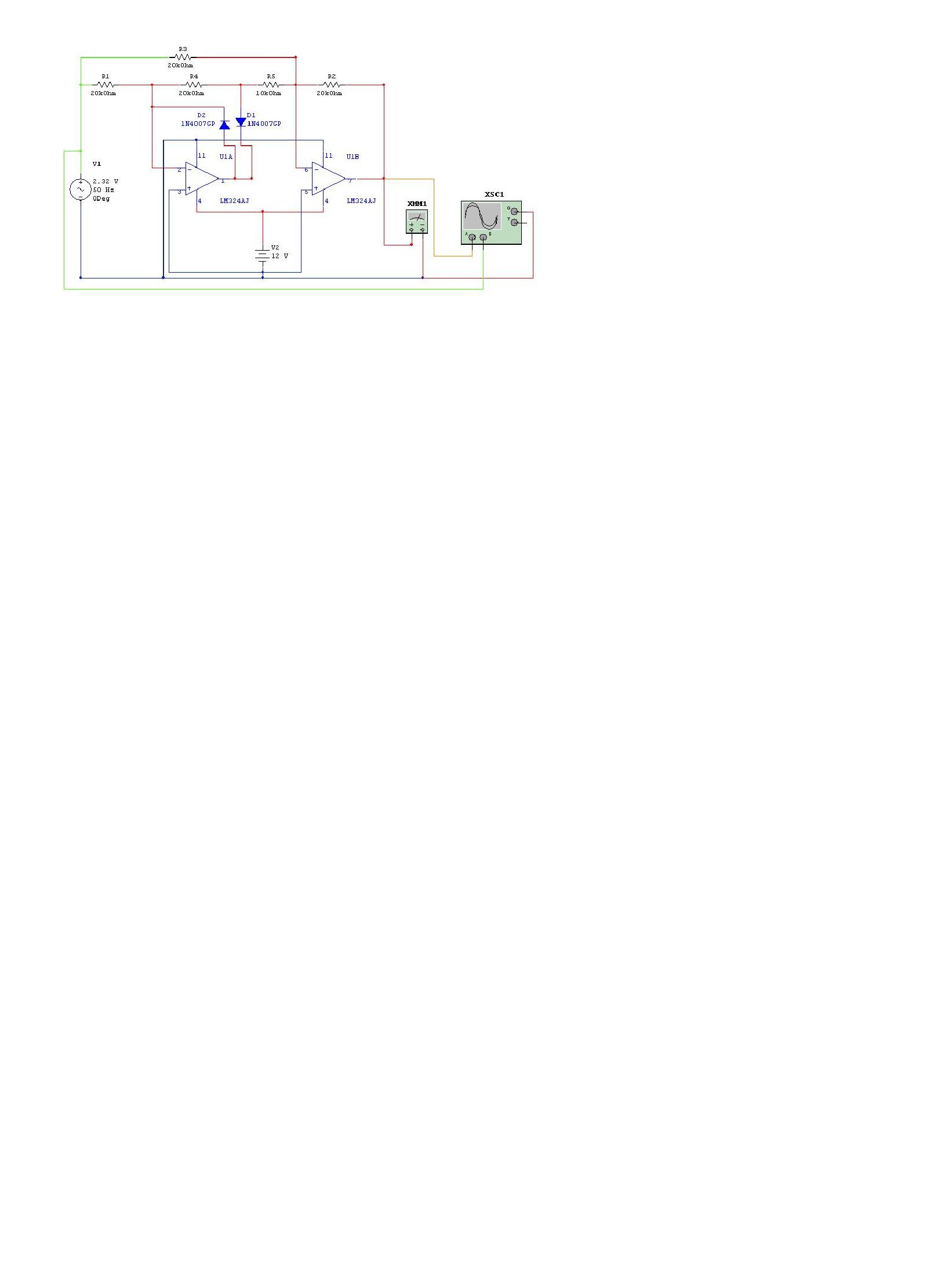

Now i want to measure this current, ie, hve to convert it to dc vtg and than give it to ADC. How do i do that. Will a simple bridge rectifier suffice.....?And wat about the diode losses....? Can i get a linear relation between input AC current and DC vtg...?
Do you need a true RMS reading or will an RMS value estimated from the peak value work for you?

@kchriste....the rms value extracted frm the peak value will do......how shud i do it.......m thinkin of using a full wave precision rectifier as i hve to read vtgs less than 0.7V....but m not able to build it using lm324.....Some Vref is the issue, but i cant make out the problem exactly.....Can nybdy pls provide me some help.......!
Post your schematic and we should be able to figure it out.
This is the ckt that i am using.....As LM324 is a single supply OP amp, I've connected only positive supply, so i need to connect ny virtual grnd or something......?

To use the LM324, you would need a negative supply connected to pin 11. If you want to use a single supply, some OpAmps can do what you want and the bonus is that you need no diodes:
The caveat is that you must use specific OpAmps for this to work.
Thanks this ckt is workin....but wat abt lm324, on its datasheet its written that it works on single power supply.....dats the USP of lm324....If -ve supply is mandatory than there's no diff between 741 and 324.....!
