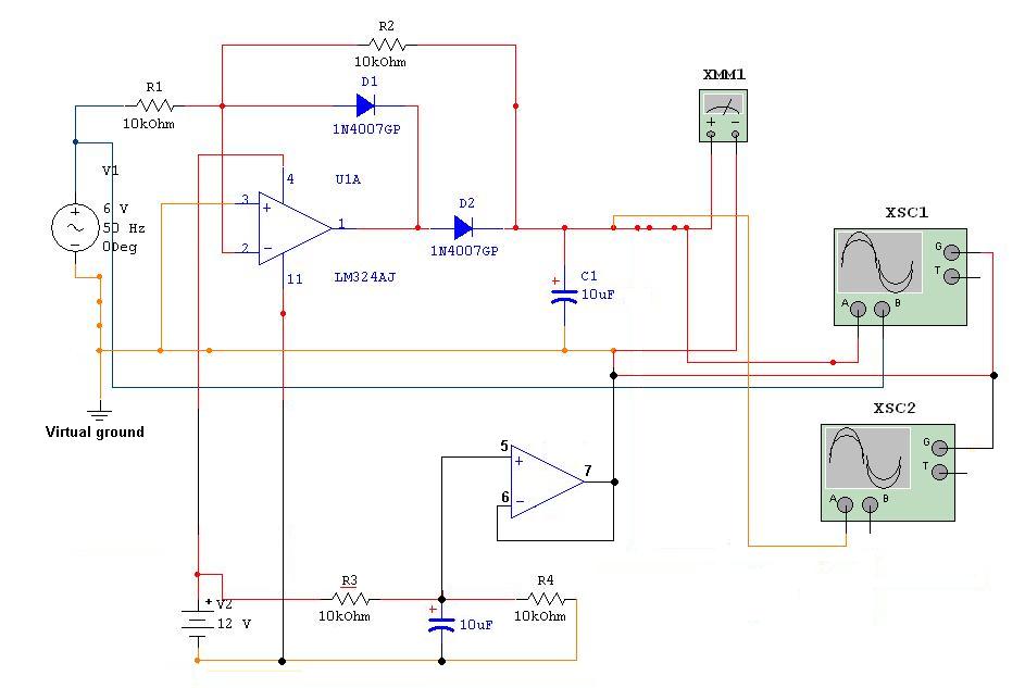

The reason is that the input voltage is going below ground. The LM324's inputs are only good down to it's negative supply rail. You could also solve this by this by using a virtual ground but this would most likely cause a problem for you when you try to use it's output and want to reference it to the negative supply lead again.

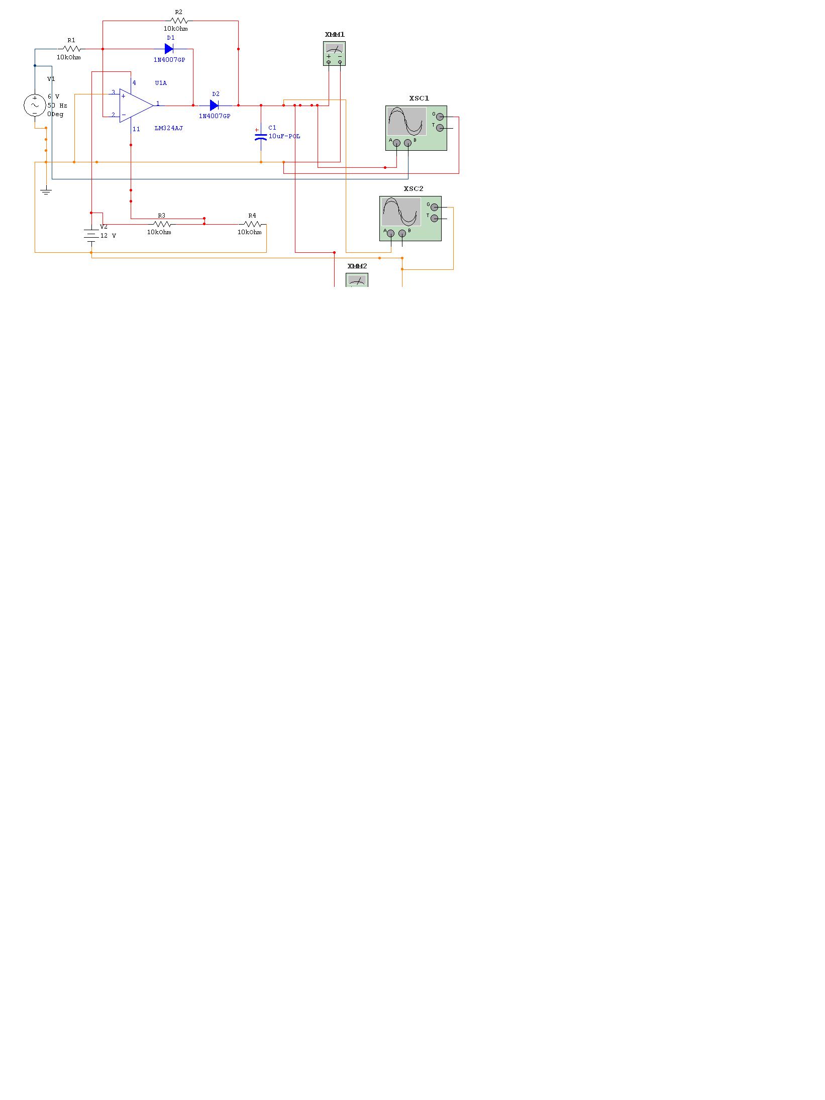

It simulated this ckt in multisim and got a correct DC output...but ven i implemented it on breadboard i dint get the correct DC output.....ny reasons for this.....?

Yes. You have connected your virtual ground incorrectly. The virtual ground needs to go to the + input of the LM324. You could try something like this, but the signal ground must be isolated from the 12v power supply ground:
