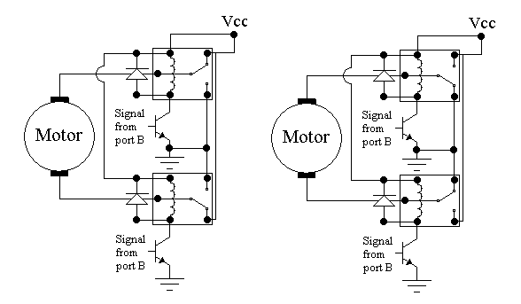

How about this type of stopping?
10 or 01 is given to stop the DC motor, will it stop quickly? Or just same as removeing the supply, slowly?
Looks like it does the same thing as shorting the circuit terminals. It stop quickly.
Disconnect motor power & short motor terminals = fast brake
DIsconnect motor terminals and leave terminals unconnected to each other = coast to a stop.
Yes, thank you so much.
