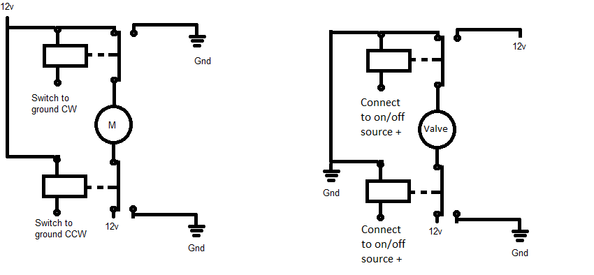

The solution proposed was a simplistic on/off function that demonstrates that you did not understand the problem. Never mind, no harm done as I solved it myself.

It seems pretty obvious that it was YOU who didn't understand his answer, which you've simply duplicated - he posted a standard polarity reversal circuit using two SPDT relays. Not an on/off solution at all - perhaps you might like to look at it again?.

What was posted by Ian Rogers WAS a polarity reversal solution.
Perhaps you should go back and review & understand that, before mouthing off?
Ian Rogers posted a solution for a "purely on/off " situation, which I appreciate, but would not solve my problem. The diagram was annotated as such and could not perform a reversal. The circuit I posted works and is there if anyone else would perhaps need it.

PS Remember-my problem was to reverse the motor polarity in the absence of an electrical supply-a bit different from the usual situation.

Tony!! I really don't give a ratsarse if you use the circuit or not.... The only reason I'm here is to help... It isn't my circuit... Well used on many situations... The circuit posted has INDIVIDUAL control for off or on ..The motor direction control part of the circuit you posted is identical..

Minimal changes required only to that simple circuit, to convert it from off/fwd/rev, to permanent fwd/permanent rev, controlled by another switched source:
