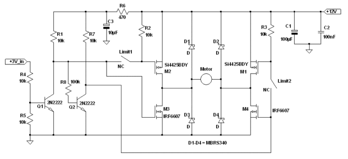

My current project is trying to control a 12v Linear actuator from a 3v output.
i have converted the 3v to 12v with a relay now i am having some trouble getting the actuator to reverse its polarity so it always stays closed. And when given the 12v signal it switches open until the signal is gone, then back to close.

The 3v is being provided by an output from a GPS unit. I have stepped the voltage to 12v for the actuator. I am now trying do have it so the actuator is always closed and when the 12v signal is sent it will open and remain open until the signal is stopped. thus closing the actuator again.

You can use the 3V GPS output as a control signal, and we can probably come up with a suitable control circuit including the relay; but the actuator will need an additional 12V power supply. You still haven't told us how much current the actuator needs and if it has built-in limit switches.
I have an additional 12v power source on board that is powering the gps unit that I can tap into. The actuator itself draws 4.5 Amps and it does have built in limit switches.

Here's a design which should do what you need. A relay powered for the lengthy times you envisage would be a considerable current drain, so has been replaced by a MOSFET H-bridge. Standby current (i.e. actuator stationary) for the circuit is ~1mA. The GPS signal controls Q1. When GPS = 3V Q1 turns on, which turns off Q2. When GPS = 0V Q1 turns off, which turns on Q2. The voltages at Q1 and Q2 collectors control the H-bridge MOSFETs, rather like a see-saw, to reverse the current flow through the actuator motor. It is assumed that the limit switches 1 and 2 are normally closed. C1, C2 and C3 provide supply decoupling to damp spurious signals. The transistor types are suggestions only: many possible alternatives exist.

Nice circuit Alec. However, looking at the original link to this type actuator the actuator motor does not appear to have limit switches so those would need to be added. This looks to be the type actuator used in automotive applications to for example raise and lower a plow blade on a truck. The operator is watching as he/she raises or lowers the plow blade. The switch in the illustration is a DPDT momentary switch with a return to off center. While this may not be of any importance it may aso need considered.
Ron
Interesting. The OP says the actuator has limit switches ;-). The OP hasn't specified any manual over-ride of the GPS control signal, so not sure if we need a centre-off switch.
