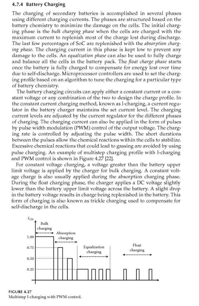

This is the charging profile for a lead acid battery cell. I don't think a battery internally can control the amount of current during its charging. As we can see that the current needs to be closely monitored and gradually decreased in Stage 2. There should be some external mechanism or device which regulates the current going into the battery. Obviously, such a device called battery charger or regulator. But how would a regulator determine that battery has entered Stage 2 in order to tightly control the current?
Don't know, but the battery manufacturer would tell you. Probably you can get a basic idea by the state of charge you are at. Knowing state of charge for a battery is not always easy, but there are various ways to estimate it. It's easier for some batteries. For example, the unloaded voltage of a lithium-ion battery is a good indicator of state of charge, I believe. Battery aging is a very difficult thing to factor in to these estimates.

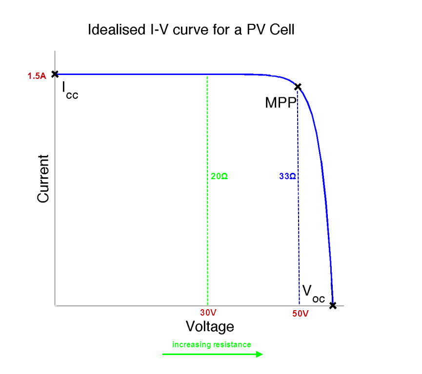

Although I have made this query before, I'm still confused so I will give it another try. Why don't we connect a load, such as electric heater, directly to the panel? We need to consider two important points about a solar panel first. First a solar panel behaves like a current source. A current source is always concerned about passing a fixed amount of current through a resistance and in order to do that it can adjust the voltage (its pressure) around the resistance. Secondly, a solar panel's maximum power is rated for Vmpp and Impp which is mostly calculated at 1000W/m^2 at 25C. Suppose the heater resistance is 20. We know that V=IR=(1.5)(20)=30V, and Power=VI=(30)(1.5)=45W. But from the figure we can see that the panel is still willing to provide more voltage (strong push or more pressure) if it is offered a suitable resistance. It appears that that suitable resistance is 33Ω. If we had used resistance or heather of 33Ω then power obtained would be almost (50)(1.5)=75W. We would only be able to utilize this extra power of 30W (75-45) if the heater's resistance can be adjusted. Or, the easier way would be to use an mppt tracker. Suppose, the tracker steps down Vmpp to 30V on its output terminal and steps up the current to 2.5A then you would be able to get maximum power even with your 33Ω heater. We should also consider another issue. If we were using a light bulb instead of heater then there would be other issues. First, if we had connected light bulb directly to the panel then in the first place we would be wasting some power and on the other hand light from the bulb would continuously vary. If we had connected light bulb using an mppt even then brightness will vary during different times of the day. So this tells us another advantage of using a battery an intermediate energy storage device. Do I make sense?
Yes you make sense. Basically, you typically want to condition power in particular ways for various devices. Solar panels are a type of unregulated power source. A converter makes a very effective regulator and is very adaptable to various circumstances.
So called PWM chargers are simply constant voltage (CV) chargers - simply a mosfet, which turns on when battery's voltage is lower and off when it is higher, or some algorithm of that sort. They can do the full profile charging. First stage - constant current (CC) - with solar panels this is practically unlimited current - you would do MPPT search, the PWM controller simply stays at 100% duty cycle. Second stage - consant voltage (CV), at which you don't do MPPT any more, so PWM is doing the same as MPPT would. Third stage - float - CV but at lower voltage level. Again both MPPT and PWM are the same here.

My other query was about sensing different states of a battery being charged. Steve has pointed out that knowing or sensing the state of a battery isn't easy. Do such battery charger ICs employ some mechanism to sense the state? It has to sense the state because the battery isn't going to tell the regulator to limit the current flowing into the battery and battery itself is indefensible against the excess current.
Regular charger is connected to a stable source, so, in theory, it can produce unlimited current. Solar panel can't. Therefore, you shouldn't worry about too much current flowing into the battery. The only thing you need to be concerned about is voltage.
As the voltage rise you limit it at a constant level, which produces the current curve that you see on stage 2.
Once you decide your battery is fully charged, you drop voltage to the float level enering stage 3. You cannot "sense" when to do that. Common practice is either to give a fixed time to stage 2, or to do it until current drops to a certain level.
If you want to sense the battery state, the best way is to count amper-hours in and out, but I don't think you should worry about the state.
I think chargers often try to sense the state of the battery, unless the battery can be charged by an automatic self correcting method. If a battery can be changed with a voltage source and resistor, then the process may be automatic and the current automatically goes to zero as the battery gets near the voltage source voltage. However, if you need to change between voltage and current charging, or do trickle charging or some other more sophisticated method, then you have to estimate the state of charge. Sometimes, the battery voltage tells you enough to make a safe charging system, and sometimes you need to be more sophisticated method. It all depends on the battery type, and people are always trying to figure out better and better methods, especially with the newer battery technologies.
The best thing to do is identify the battery type/technology you are using, and read up on how charging is done for that type. There are hundreds of different battery types, so it's not easy to answer generally.
