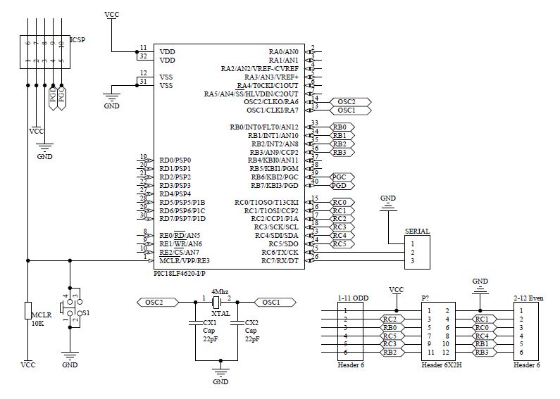

yeah heh... im recreating the PICDEM Z board here since i have 2 18LF4620 PICs here i will test it the way they did... The only thing is the PICDEM Z board has a 4Mhz Crystal and i have on 10MHZ and 20MHZ crystals around... but i think i have a few 4mhz crystals on a board i can probably pull.

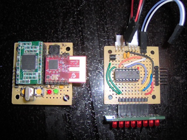

I built a few PICDEMZ like PCBs but left off the serial and switches. I used a resonator instead of crystal and caps. Processor pins come out to the card edge. The SMD temperature sensor is under the radio. It can be built as a SS PCB with 2 jumpers. Regulator is a TO-92 package.
The board to the left is an earlier version.

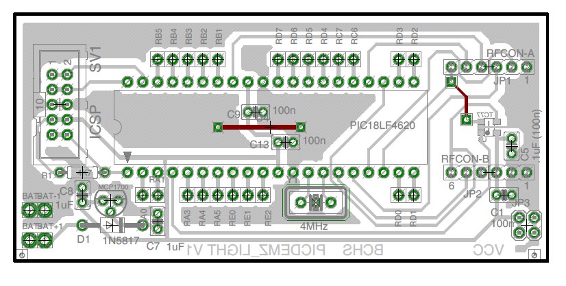

im actually going to make a PICDEM Z light of my own heh I like yours tho...
I will take a look into the MCP1700 looks nifty and cheap heh

WOW those are expensive heh but heh... Anyway... im making my schematics now... to clone the PICDEM Z... the basics are in... tho and well heh its not much to add but some LEDs and buttons. really i wonder about the price....
Very nice....... It's definitely time to get off the fence and start etching.

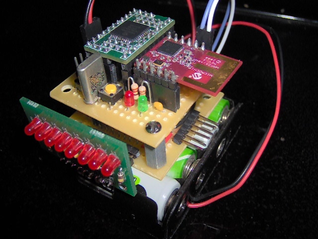

Here is an PICDEMZ ice cream sandwich, with a 16f688 in the middle. It takes an very abbreviated XBee approach of decoding ascii from the Microchip radio appnote.

I am glad to see other members working with this radio.
@Atomsoft
I was fairly sure you would want to do you own design. That is why I did not upload the eagle files. :) I am using these to proto type more app specific boards rather then run the demos. The thinking is that a breadboard or 2nd PCB will provide whatever else is needed.
@nickelflippr
That is a neat/nice bit of work you have there. The etching is one more process to tinker with. I tend to get caught up in tool processes and that slows me down but I enjoy it.
Heh these seem nice and fun once i can get at least 1 board made. This way i have 1 that is stable and can build the other to do what is needed..
Compact is the name of the game. Im going to try and make the board small as possible. This will reduce the final cost by a few bucks. I might even look into
the TQFP package... Just so i can reduce size further

I can do .8mm pin pitch. I am working with the PIC18F67J11 .5mm pin pitch. The 18LF4620 does not have enough ram to code the coordinator I have planned.
The artwork is OK from the printer but when it comes off the laminator I am getting a bit of distortion on a few pads. I could build as is but want to figure this out. Heat pressure (roller condition) etc.
