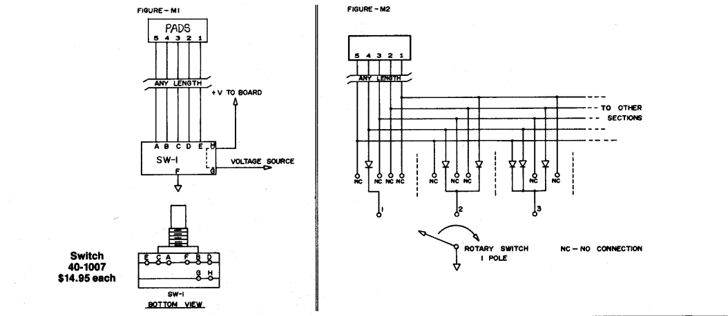

OK, I think I got the voltage. There is 0.1 between each of the 5 terminals and the common. Just so you can see where the dip switch is used this is a schematic of the ctcss package I am using: https://www.repeater-builder.com/com-spec/pdfs/com-spec-ss-32smp.pdf
My last post might have been confusing. So I will clarify. The ground bus (shown in the schematic) is negligible voltage 0.01 to 0.2 (seems to vary) across each of the 5 dip terminals relative to the ground bus during transmit.
I was just going to run the counter outputs to the 5 terminal but I am wondering if that would work now or if I need some sort of interface between the counter outputs and the 5 dip terminals. But since it just needs to each of the 5 pads (as required) to ground I think I need to do something there. What do you suggest?

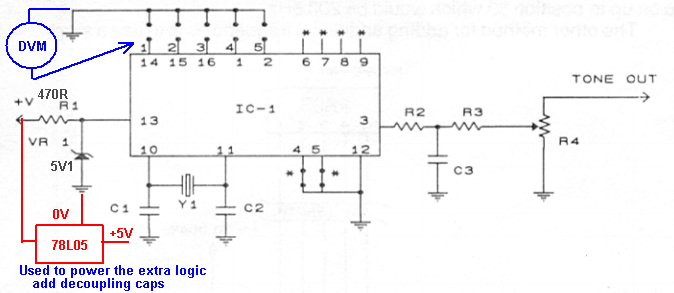

hi Roger,
A clip from the pdf, please confirm this is the device in question.
When you measure voltages on the IC, use the bottom end of the 5.1Vz as the meters 0V connection.
Re-measure the voltages on IC100 switch pins, using the 0V as stated, I would expect them to be about +5V when not switched to 0V
I would recommend that when you connect the extra logic, you use the the 0V mentioned, as the ONLY 0V connection point.
It would be advisable to have a 5Vregulator connected to the +V terminal [top end of the 470R]. a 78L05 regulator would be OK.
Let me know what you measure...

When measuring the encoder in the radio, the two things that matter are the (open-circuit) voltage across an open DIP switch, and how much current flows through your DMM when it is set up to read current and the probes are connected across an open DIP switch.
Well as I said. The voltage I get where you indicated in the diagram is 0.1 I tried checking for current and I get 0. Again if I check the dip common to radio ground I get 6Ma and 7volts. I am wondering if I am not showing anything because of RF. The encoder only comes on in transmit.
I checked, there is no rf going through it. Sorry, I cannot get any real reading across those points so let's assume that it is 7 volts where would I go from there. I only need to close the circuit with something that will handle 0 to 7 volts. What would I use for that.

It explains in the text and shown in the select switch diagrams how to connect them.
You can see it states that to select a pin , connect it to 0V.
